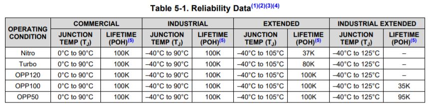

I'm referring to Table5-1 in
https://www.ti.com/lit/ds/symlink/am3352.pdf
Customer are interested in POH for AM3352BZCZA60 and AM3352BZCZT60 .
The temperature range for A is -40~105C, and it for T is -40~125C.
And, Table5-1 says as below.
Table5-1 says that, POH for AM3352BZCZA60 with 105C is 100K.
But, it doesn't say anything about POH for AM3352BZCZT60 with 105C.
It only say about POH for AM3352BZCZT60 with 125C.
What customer would like to know if POH for  both AM3352BZCZA60 and AM3352BZCZT60 are
same at the same condition (OPP, temperature range).

  • From Datasheet figure 8-1, you will see that the temperature grades have Commercial, Extended, Industrial, and Industrial Extended names in the parenthesis.  These names tie to the headers in table 5-1 that you included in your post.
    You can now see that temperature grade T (Industrial Extended) has a reduced POH compared to temperature grade A (Extended).
    I have requested that the next release of the AM335x datasheet include the speed grade letters in the headers of table 5-1.
    --Paul

  • Table 5-1 provides the POH values for a device running at the stated max Tj
    The temperature grade options (Commercial, Industrial, extended, and Extended Industrial) provide options to customers to purchase the correct part for their end use case.
    Grades A and T are not equal. Grade A has a maximum Tj of 105C but grade T has a maximum Tj of 125C.   Grade A should NOT be operated with a Tj above 105C.
    Now, if you limit the Tj of grade T to 105C, then you should see the same POH numbers. However, there would be no point in using grade T if the intent was to limit the Tj to that of grade A.
    --Paul
    Yes, your comment is definitely correct. I cannot publish the details but customer need that information.
    It's what we'd really like to know. Thanks a lot.
