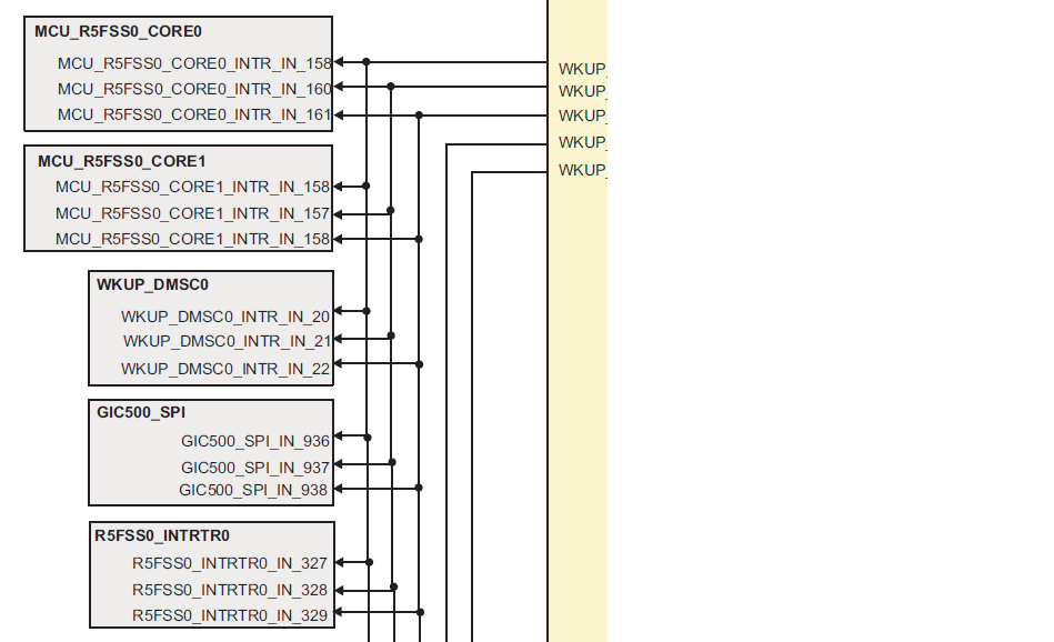

  • Hello Keerthy,
    1. As I understand from your reply, the alerts can only be monitored through interrupts and not status flags.
    2. Initially we had the interrupts enabled when we integrated the baremetal application provided with vision_apps which has Sysbios running on R5F. However the application hanged during the interrupt registration. So, we disabled interrupt registration and wanted to monitor alerts through status flags.
    3. Can you help us register the interrupts from vision_apps (Sysbios R5F).
    In addition to above we also tried to run the baremetal application on EVM using debugger. The application get loaded successfully, core enters running mode, but we cannot see any prints on UART console. We followed the PSDK user guide for debugging using CCS. What can be the issue..?
    Dipti Natu

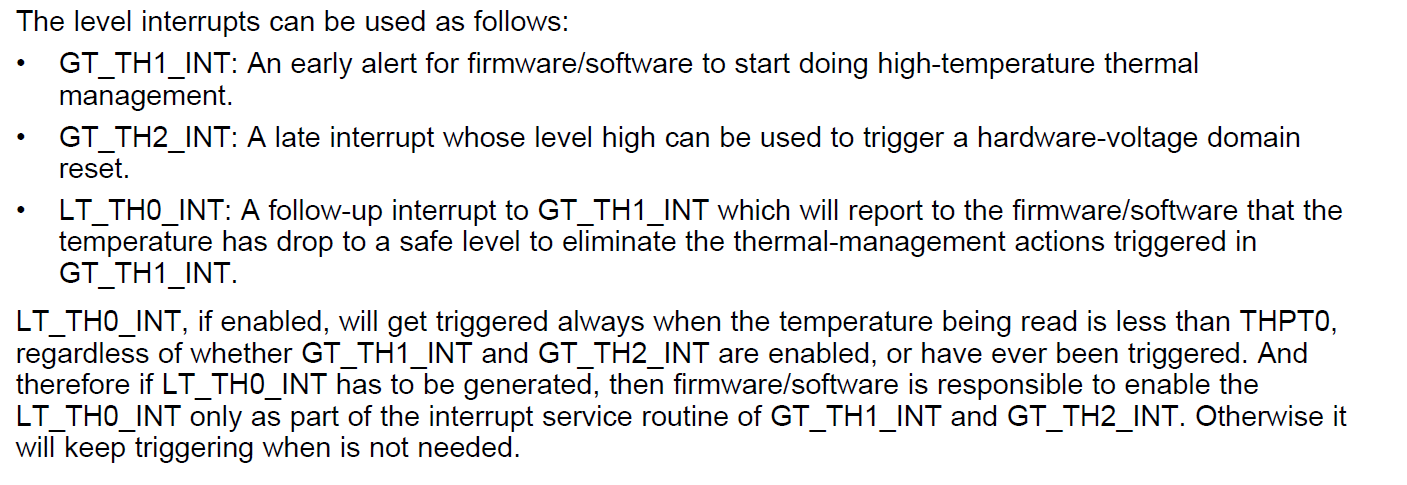

  • Hi Dipti,
    For the thermal alerts check this:
    So as soon as the GT_TH1_INT fires you will need to take some cooling action otherwise that status will be set like how you have observed.
    for TSHUT:
    What is the behavior that you see when you hit the TSHUT temperature? Can you elaborate?
    Keerthy

  • Dipti Natu said:
    [MAIN_Cortex_R5_0_0] 00256.528 TaskGetEnv: FATAL: NDK not initialized
    Dipti,
    It took sometime while i was debugging with our expert. The root cause is that the CSL library for temperature alerts
    was entirely written for MCU R5F0 & you are using MAIN_R5F0.
    That means all your interrupt numbers are wrong.
    You have used 158, 157, 156 but Main R5F interrupt numbers are 327, 328, 329.
    So i first request you to try on MCU R5F0 to check if everything works as expected & only if that cannot
    be used then switch to MAIN R5F0 with the appropriate interrupt numbers.
    Let me know if you are unblocked & can resolve this,
    Keerthy

    2. In order to register the interrupt from the MAIN domain we changed the interrupt numbers to 327,328,329 as you suggested to try.
    Due to this change the application doesn't hang but still there are no interrupts seen.
    As you have mentioned earlier, that the CSL library is exclusively written for MCU R5F but we need this feature in our stress test application in vision_apps.

    I have got the thermal alerts CSL working on Main R5F0. Interrupt routing is a bit more complicated on Main R5F side.
    I will clean up the code & share that by tomorrow.
