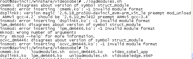

can anyone tell me what i should do?
You will need to rebuild all your .ko files while pointing the builds at your Linux kernel source code.
I can see that dsplinkk.ko was built pointing to the "2.6.10_mvl402..." Linux source code, but you are running "2.6.18_pro500-davinci...". So you need to build all the .ko's while pointing the build at the source code for the "2.6.18_pro500-davinci..." kernel.
Here's a page regarding rebuilding .ko's on the OMAP-L1 SDK, but the instruction within should apply to DM6446 as well: http://processors.wiki.ti.com/index.php/Building_The_OMAP-L1_SDK#Building
