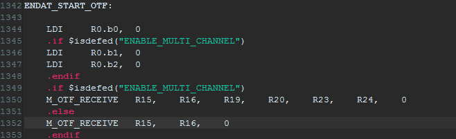

    My customer tried to debug this issue and found error return(-1) in endat_wait_initialization() function.
    at this time, they found FW was stopped in below.
    it seemed the failed to communicate with EnDAT encoder as there is no clock signal from AMIC120.
    Please let me know how they can generate clock signal from PRU1 of ICSS0.

  • SI,
    FW needs to be built for PRU1. Pls see attached FW which was ported to work on PRU1.
    endat_main.asm
    Further, EnDAT driver application also needs to be modified to make sure all the register settings are done for PRU1.
