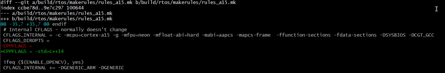

As we know on A15 core we can Bios RTOS as well as Linux & but compiler for RTOS & Linux is different.
ifeq ($(A15_TARGET_OS),Bios)
CODEGEN_PATH_A15 ?=$(TI_SW_ROOT)/cg_tools/linux/gcc-arm-none-eabi-4_9-2015q3
endif
ifeq ($(A15_TARGET_OS),Linux)
CODEGEN_PATH_A15 ?= $(TI_SW_ROOT)/os_tools/linux/arm/gcc-arm-8.3-2019.03-x86_64-arm-linux-gnueabihf
A15_TOOLCHAIN_PREFIX ?= $(CODEGEN_PATH_A15)/bin/arm-linux-gnueabihf-
endif
Add the below changes to support C++14 for A15 Bios RTOS
We Just need to set the flag CPPFLAGS = -std=c++14
Gaviraju
