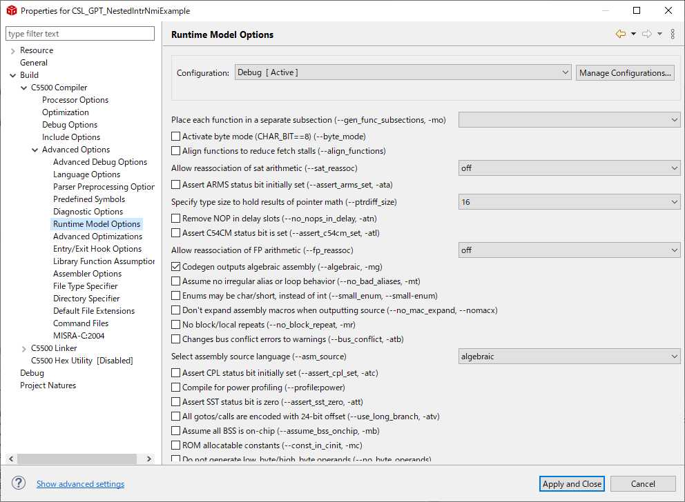

  • Hi Mukul,
    Thank you for your advise.
    I have added the spaces more than 20, however, it showed "parse error".
    I have checked the Runtime Model Options as attached.
    "Algebraic" is selected with this project.
    "INTR" is in Mnemonic Instruction Set.
    so I changed the code below and the error was disappeared.
    asm(" intr(10)");
    I am not sure if it could make a software interruption correctly or not.
    But I have asked a customer to try it.
    Will keep you informed.
    Hitoshi
