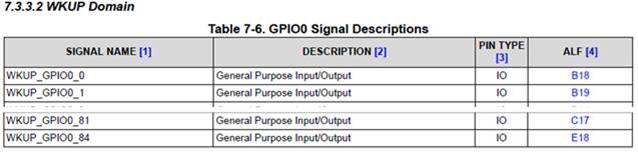

  1. Is there any description for IO retention that can share to me? I found below words in TRM, but I suspect it is not right one.
  1. how many IO can be wake-up source?
are all GPIOs in WKUP domain wake-up source? For example, for DRA821U, 85 GPIOs in WKUP domain.

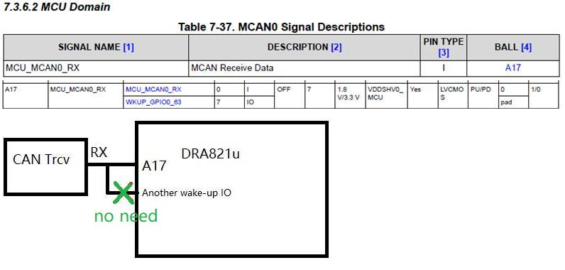

3.I found MCU domain CAN RX can pinmux to WKUP_GPIO. For example, ball A17 is WKUP_GPIO0_63 by default.
I think A17 is enough to support wake-up and normal working, see below draft chart. Would you please correct me if it is wrong?
But for MAIN domain CAN RX, another wake-up IO need be connected to its RX. right?
