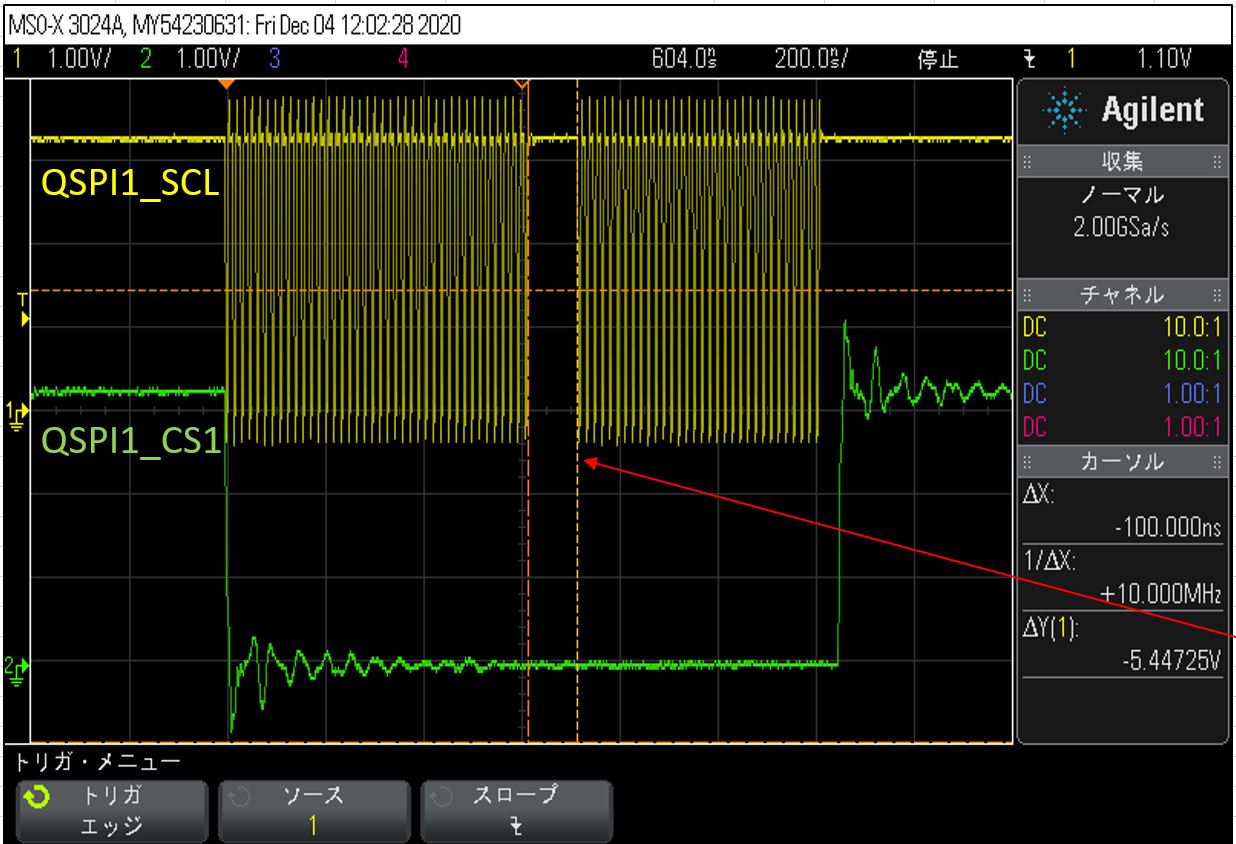

My customer would like to know about the QSPI clock.
When reading the U-boot, the clock stops as shown in the following image.
What is the cause of this clock stop?
Also, is there any way to avoid this stop?
My customer supposes that CMD 8bit, Address 16bit, and DummyCycle2bytes are
before this stopping interval, and data 32bit is after this stopping interval.
The register setting is as follows.
Register                       Address               Setting value
CM_DIV_H13_DPLL_PER              0x4a008160         0x00000204
QSPI_SYSCONFIG                           0x4b300010         0x00000004
QSPI_SPI_CLOCK_CNTRL_REG    0x4b300040         0x80000002
QSPI_SPI_DC_REG                          0x4b300044        0x00000050
QSPI_SPI_SETUP1_REG                 0x4b300058        0x09030002
QSPI_SPI_SWITCH_REG                 0x4b300064        0x00000001
CTRL_CORE_CONTROL_IO_2        0x4a002558        0x00000200

  • The countermeasure was not verified by TI, but was accepted by the customer as fixing his problem.  I stand by that recommendation when using the QSPI Configuration Port.  But from my reading of the registers given above, this customer is using the SFI interface.  So I don't think the solution in the other E2E thread will work.
    Can you confirm that SFI mode is being used when the customer observes this phenomenon?  I'm not sure how much control the user has over timing when SFI mode is being used.  Also, my reading of the registers is different from the description in the original post.  The original post "supposes that CMD 8bit, Address 16bit, and DummyCycle2bytes are before this stopping interval, and data 32bit is after this stopping interval."  However, the registers given would indicate that they are using 8 bits for command, 8 bits for address, and 9 bits for dummy cycles.  Please ask the customer to clarify this.
    -Zack

  • Hi Zack,
    I checked the following items from my customer.
    Zack: Can you confirm that SFI mode is being used when the customer observes this phenomenon?
    >If SFI mode means that the mode using SFI Translator = access using Memory Mapped Port, then "Yes".
    Zack: However, the registers given would indicate that they are using 8 bits for command, 8 bits for address,
    >As for DummyCycle, the register value was incorrectly written.
    Correctly, QSPI_SPI_SETUP1_REG: 0x4b300058 should be "0x00020903".
    If you have unclear part, please point it out.
    Kanae
  • Kanae,
    I understand the QSPI_SPI_SETUP1_REG now.  Thanks for the clarification.  When reading from the QSPI as a memory mapped device, the SFI Translator has control over the state machine.  As such, there's nothing that you can do about the delay between the dummy phase and the data phase.  Please let me know if the customer has any other questions.
    -Zack

  • Kanae,
    "Am I correct in understanding that the delay between dummy and data is the delay that
    occurs between #4. and #5. as described below in TRM; 24.5.4.1.2 SFI Translator,
    and that there is nothing to do about this delay in SFI mode?"
    That is correct.
    -Zack
