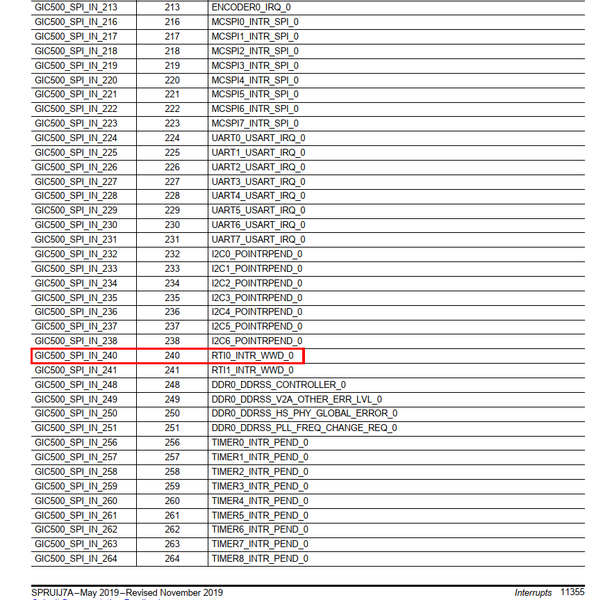

I configure RTI0 watchdog from A72 side and RTI status register indicates that watchdog timeout period has expired as following. And I configure watchdog reaction to NMI, it should generate a no-maskable interrupt.
I enable interrupt id 240 for RTI0 in GIC. But the GIC interrupt handler can not be triggered. And I am sure GIC is ok for other interrupts. Please help me analyze, thanks~
