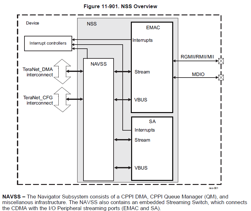

  I have a query about the dependency on NAVSS (QMSS and CDMA) for other modules.
  From the specification and the SDK 6.03 code base, I think QMSS and CDMA is used by  EMAC and Security Accelerator (SA) modules only. Also, did not find the APIs of QMSS  and CDMA being invoked from any other drivers.
  PRU ICSS also does not seem to use CDMA for data movement (did not find any reference in specification, also APIs of QMSS and CDMA were not invoked).
  Is my understanding correct? Or is QMSS and CDMA used my any other module other than EMAC and SA?
