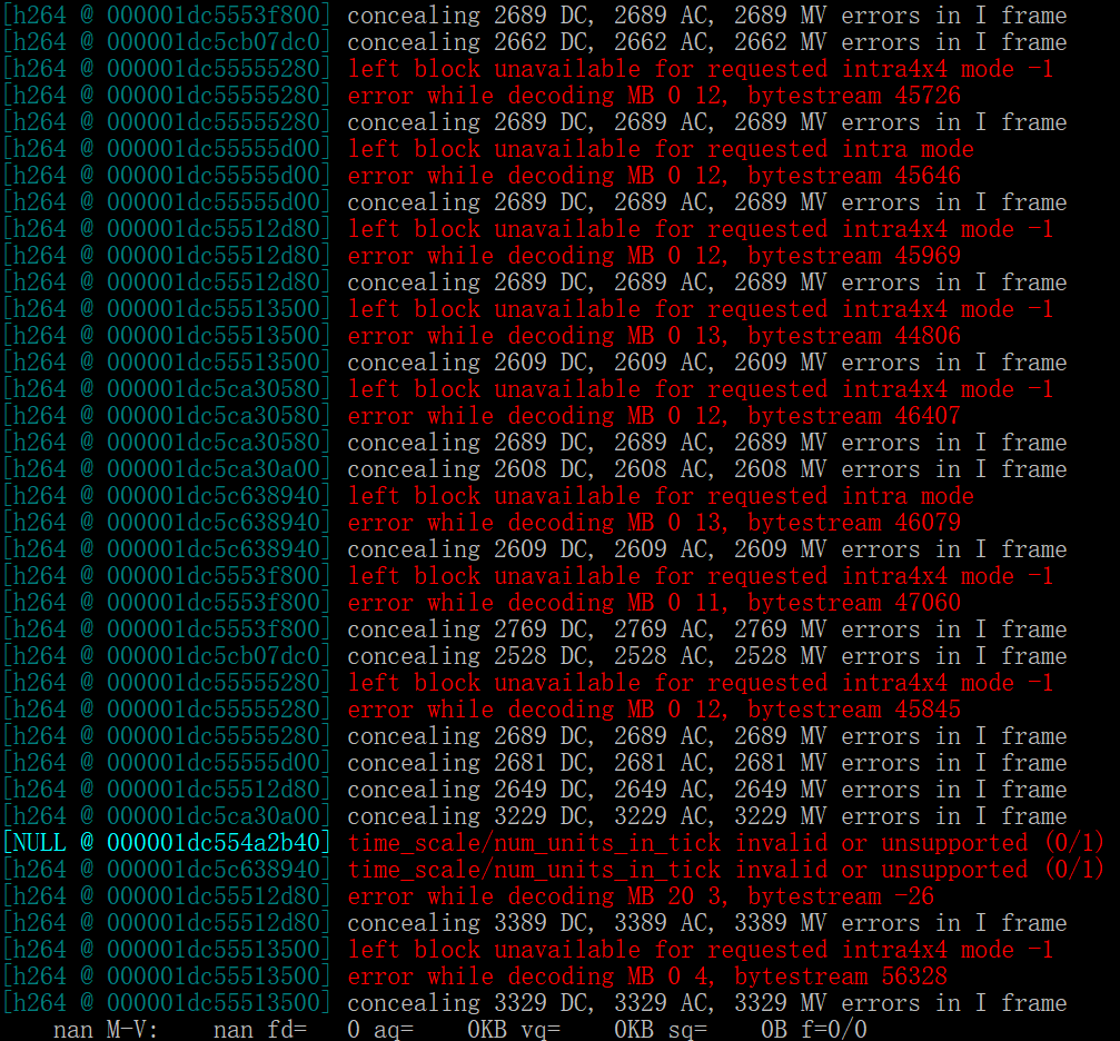

we use the folowing encoder parameter to generate H264 stream(store these output from OPenVX encoder node to one file), but when decoding this H264 stream. we find these 3 issues:
any idea about this? thanks.  attached more logs.

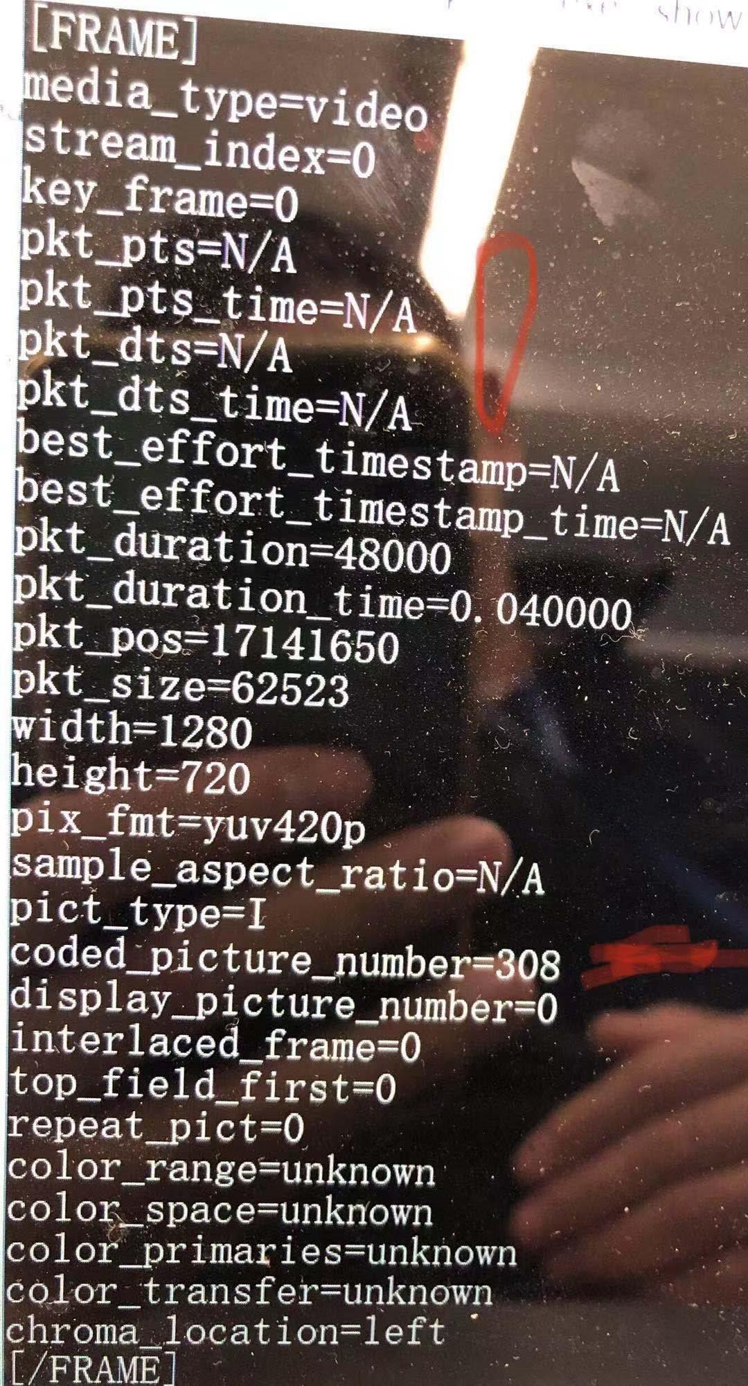

1:  after check the H264 stream by FFMPEG tools, we find that there are no PTS and DTS in H264 packet .
2: time-scale in H264 packet is always 0.
2:  we have set ctx->rc.intra_freq = 30, but all frame type is I , there are no P frame.
Do i need to set this ctx->vparams.intra_cnt to 30 also?
3: there are some MB decoding error.  i already set ctx->rc.bits_per_second = 15000000.  100万摄像头
