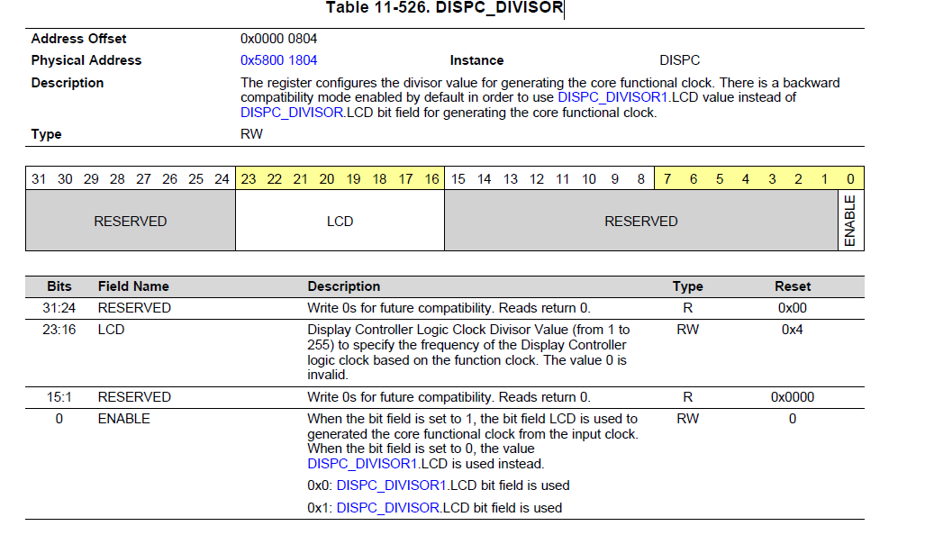

  • Hi Tim,
    So you mean use DISPC_DIVISOR register to slow down the pixel clock? But it may effcet display fps.
    Why will it affect fps? DISPC_DIVISOR will reduce clock for DSS and should slow down DSS M2M WB path also.
    DSSM2MWB vs Display + Capture path are different..  Because Display + Capture path is controlled by final output pixel clock.. and DSS M2M WB path will run at DSS clock, not by any pixel clock..
    Rgds,
    Brijesh
  • Hi Brijesh,
    So you mean configure the register below right?
    Now we set it as 0x00010001. Would you please tell which value should I set?
    Thanks for your help!
  • Hi Tim,
    Yes, that's correct, can you try setting 0x00020001?
    Rgds,
    Brijesh

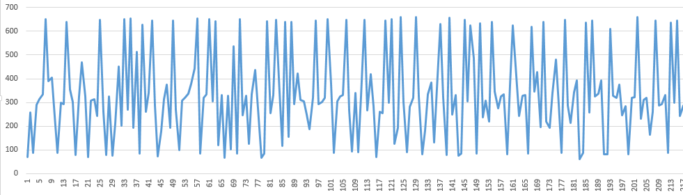

  • Hi Brijesh,
    After I set it as 0x00020001, display shows below. Did some other registers should I configure also?
    Anyway peak data is lower than 700MB/s.
    Actually I hope we can smooth this wave like a straight line. For example, it rise and fall between 500MB/s.
    Thanks!
    BR/Tim
