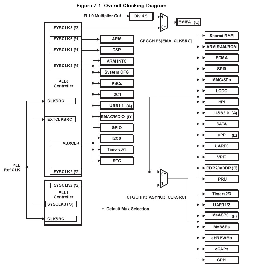

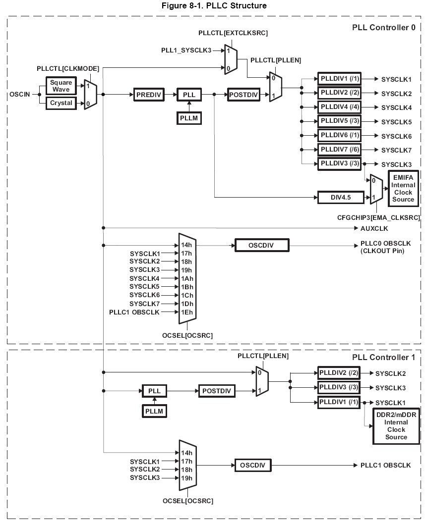

However, there seems to be conflicting information within the Freon Reference Guide in regards to the clock tree.
Let's take for example the mDDR peripheral.
Under Figure 7-1 below, it can only be driven from PLL0, while from under FIgure 8-1, it can only be clocked under PLL1.
Is there a single diagram or spreadsheet that I can track for the whole system clock tree with dividers and clock gating registers so that I can ensure that if I do want to change my PLL clocks, I would like to easily indentify which peripherals will be affected.
    Have you reference the caption (B) in the clocking diagram? It points you to another section that explains the clocking for DDR2/mDDR

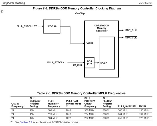

    The 3rd clocking diagram is even more confusing.
    The below shows that the DDR module requires both PLL to be active, PLL0_SYSCLK2/2 to drive VCLK and PLL1_SYSCLK1 to drive the DDR PHY.
    This diagram does not match what was shown in the above clock tree.
    I just need to know which to follow and if there is a possibility of running everything with just one PLL0?
       I looked at the clocking diagrams, and they appear to match to me. Figure 7-3 shows that VCLK is supplied through PLL0_SYSCLK2/2 (Poor working perhaps, but this a a divide-by-two of PLL0_SYSCLK post CHIPCFG3[ASYNC3_CLKSRC] Mux). It also shows that DDR PHY clock is supplied from PLL1_SYSCLK1. This same connection is shown in Figure 8-1 post PLLCTL[PLLEN] Mux as well as post PLLDIV1 clock divider.
    However, note that PLL1_SYSCLK1 can be derived from the output of the internal oscillator (see figure 8-1) by configure the Mux PLLCTL[PLLEN] to select input 0.

  • Hi
    Thanks for your replies.
    From the mDDR block diagram, it seems that regardless of what peripherals I am using, the mDDR already dictates that both PLL would be required.
    Can you confirm this is intended?
    PLL0 would be used for VCLK and PLL1 would be used for DDR PHY... seems that there is no way out
