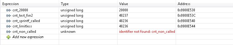

1* Figure 3 shows that bounded_func() variable (cnt_20000) is counted up to 20000 which means that bounded_funct() should have been called 20000 times. However, as you can see in Fig 4. It is called just 35 times.

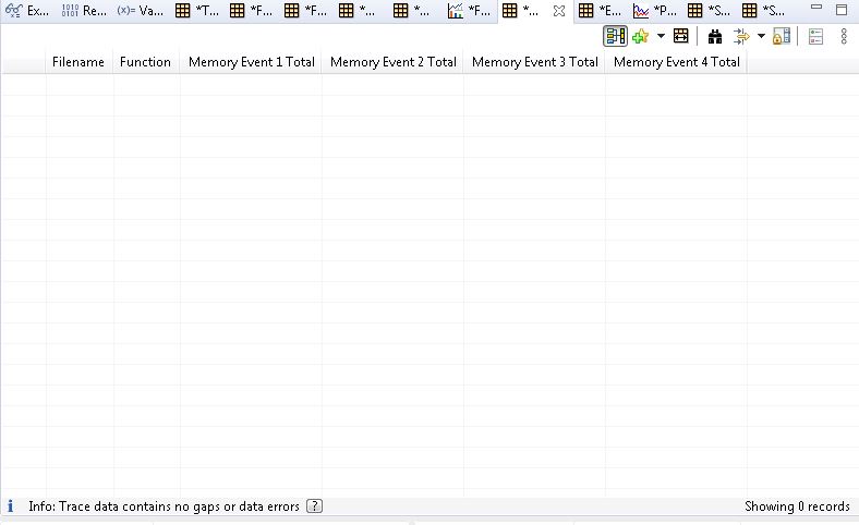

3* There is no record for Cache Event Profiler and Stall Cycle Profiler (fig 5)
Figure 3 Expressions of the functions

Figure 5 Cache Event Profiler View

    I uploaded the same project to the DSP core and observed the expected values are satisfied in this core for trace data.
    Then I tried it back to the ARM core, it still suffers from the accuracy.
    Maybe this experiment would help you.
    Also for DSP Core, I couldn't see any result for code coverage analysis.
    I tried to change the transport type to ETB but the same accuracy problem for ARM cores are continuing.

    • Trace values do not look correct when streaming trace or using ETB.
