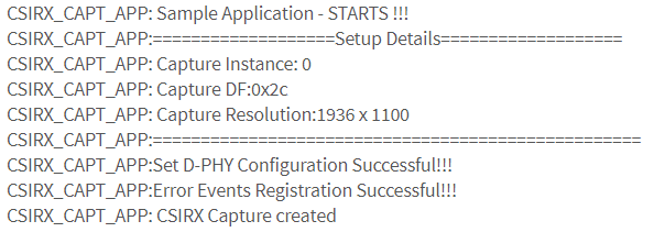

I am using J721E EVM connected to UH940 in order to capture MIPI CSI2 data coming from this deserializer.
I'm trying to use csirx_capture_test example but it doesn't work.
I deleted the part related to Fusion board and imx390 since I don't use them but still doesn't work.
the HDMI output of the infotainment board is connected to a display screen.
Here is the output log from CCS console:
Could you please tell me what is the issue why I don't see the data displayed in my screen?

  • Hi Brahim,
    Default PDK CSIRX sample application does not configure/use DSS, so you won't be able to get the data on to the display. It'll just capture 1000 frames (controlled through 'APP_CAPT_FRAMES_CAPT' macro) and will then stop the capture.
    Please take care of the following things:
    • Replace Fusion board and IMX390 configurations with UH940 configurations. Placement of this configuration in the code matters. Please follow the existing sequence.
    • Please make sure that UH940 and J7 CISRX have the same number of lanes and the same lane speed configurred.
      • Default application has 4 lanes with each lane running at 1.5 Gbps
