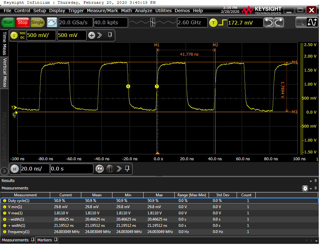

    He  will also send you the measurement waveform for the clock input from the crystal,
    but we recognize that it is not a problem in terms of accuracy.
    [00_24MHz Supply clock waveform]
    He also measured the waveforms when the CLK_SEL register is explicitly specified and when it is not set to its default value.
    00_wdt.zip
    When the register is explicitly set, WRMRST is output about 83ms per 1s later than the set value.
    When not explicitly set, WRMRST is output about 190ms per 1s, earlier than the set value.
    Details of the waveform are shown below.
    Output time of WARMRST
    - 0x_wdt xs : When PRCM_CM_DPLL_CLKSEL_WDT1_CLK is explicitly set to 0x0000 0001
    - 1x_wdt xs : When PRCM_CM_DPLL_CLKSEL_WDT1_CLK is set to the default value (0x0000 0001)
    ch1 (yellow): Timing when WDT is enabled
    ch2 (green): WARMRST output timing
    Please let us know if you notice or correct any problems with the PLL clock settings or waveform status.
    Kanae
