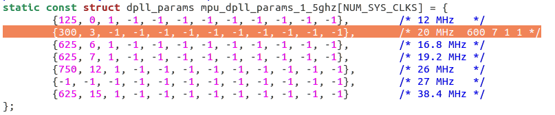

Customer used his own AM5718 board. He failed to upgrade the CPU speed to 1.5GHz.
He used debian. He modified mpu_dpll_params_1_5ghz in HW_DATA.C by referencing below website.
https://software-dl.ti.com/processor-sdk-linux/esd/docs/06_03_00_106/linux/How_to_Guides_Linux_Porting_Guide_AM571x_AM570x_Speed_Grades.html
The dpll_mpu_ck is correct but the dpll_mpu_2_ck is only750000000.
He did a few tests as below:
1. Upgrade the clock to 1.2GHz, the system could run for about 12 hours and then down. M=240,N=3,M2=M3=1;
2. Upgrade the clock to 1.3GHz, the system could run for about half an hour and then down. M=260,N=3,M2=M3=1;
3. Upgrade the clock to 1.4GHz, the system could boot up and then down. M=280,N=3,M2=M3=1;
4. Upgrade the clock to 1.5GHz, the system could not boot up, it always reads the MMC1. M=300,N=3,M2=M3=1;;
Dumping the CM_SLKSEL_DPLL_MPU and CM_DIV_M2_DPLL_MPU registers, both of them are correct. DCC_EN=1,DPLL_BYP_CLKSEL=1.

  • Dear Keerthy,
    Thanks for your quick reply.
    Customer added the table to hw_data.c. He wrote it according to the struct dpll_params mpu_dpll_params_1ghz table. Since he wanted to upgrade to 1.5GHz and he used 20MHz crystal, he modified the M=300,N=3,M2=M3=1 to get 1.5Ghz CPU clock.

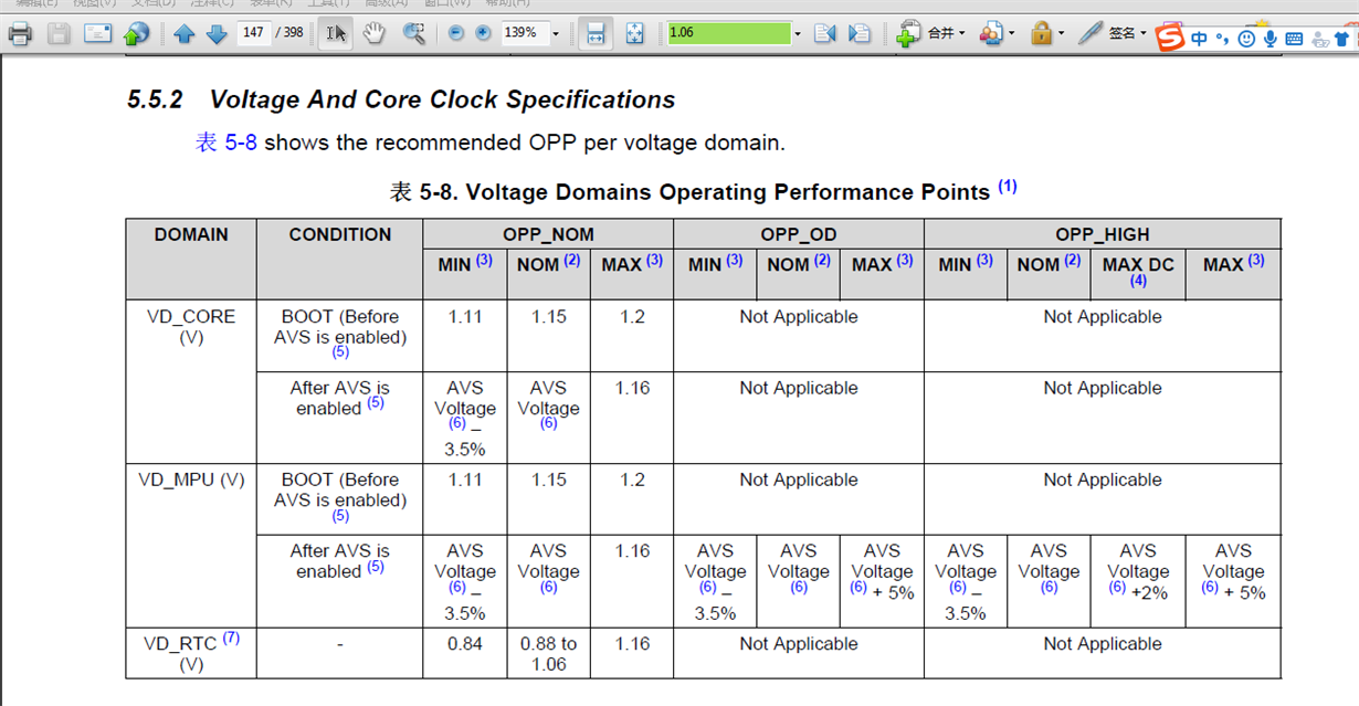

  • Keep in mind that there are more things that must be configured in order to run at 1.5 GHz:
    • Operating voltage will be higher
    • AVS e-fuse settings must be observed
    • ABB e-fuse settings must be observed
    Most of these items are specified in the board.c file.  For example, here's a snippet:
    .mpu.value[OPP_NOM] = VDD_MPU_DRA7_NOM,
    .mpu.efuse.reg[OPP_NOM] = STD_FUSE_OPP_VMIN_MPU_NOM,
    .mpu.efuse.reg_bits = DRA752_EFUSE_REGBITS,
    .mpu.addr = TPS659038_REG_ADDR_SMPS12,
    .mpu.pmic = &tps659038,
    .mpu.abb_tx_done_mask = OMAP_ABB_MPU_TXDONE_MASK,

  • Hi Brad,
    Thanks for your reply.
    There is no VDD_MPU_DDR7_HIGH definition in uboot, so customer added it ant set it to 1250, but the uboot still can't boot at 1.5GHz.
    Besides, it seems that the MPU doesn't support OPP_HIGH.
    Thanks.
    Rgds
    Shine

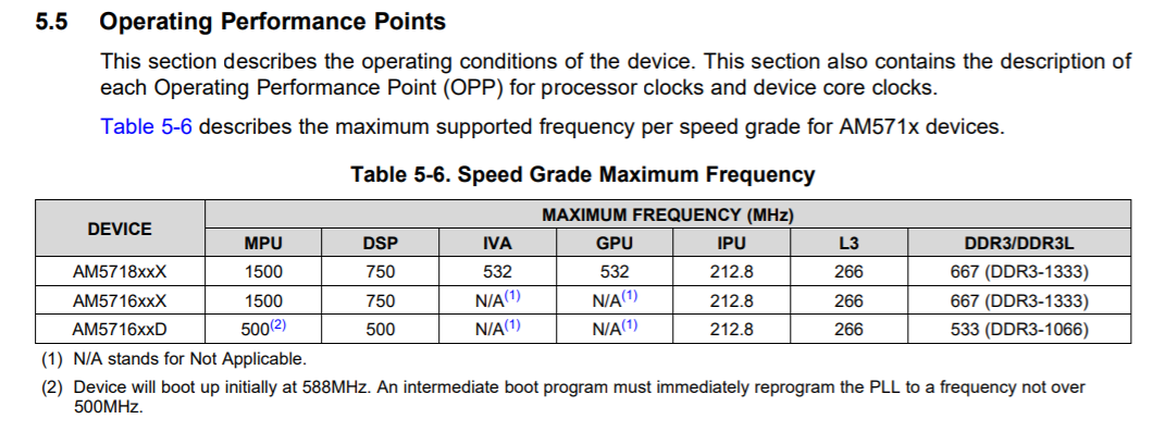

  • Hi Shine,
    AM5718 Data sheet: https://www.ti.com/lit/ds/symlink/am5718.pdf?ts=1608648280616&ref_url=https%253A%252F%252Fwww.ti.com%252Fproduct%252FAM5718
    5.5 Operating Performance Points
    AM5718xxX devices support 1.5GHz.
    Keerthy
