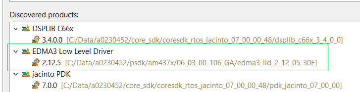

    From the error description, it seems the build is failing due to EDMA3 library path for AM437x is not found. Can you please check CCS product discovery page has EDMA3 library installed correctly (CCS-Window->Preferences->Code Composer Studio->Products). A reference screenshot is shown below
    Please note that EDMA3 library is unique for AM335x and AM437x. If you have already added EDMA from Processor SDK for AM335x, uninstall first and then rediscover from Processor SDK for AM437x. Please let us know if this resolves the problem

    PROCESSOR-SDK-RTOS-AM437X  06_03_00_106 includes edma3_lld_2_12_05_30E, and the projectCreate script also expects this version:
    set "EDMA_VERSION=2.12.05.30"
    I see that you are using edma3_lld_02_12_00_20 which is incorrect.
    Farrokh Eshragi Azar said:
    may be because I had another version of edma3_lld already installed in my \ti folder. So, another thing I can and will do, is to uninstall the edma3 that I have, uninstall PROCESSOR SDK RTOS-AM437x and reinstall PROCESSOR SDK RTOS-AM437x and see if the problem will go away.
    This looks like the case. A simple test will be to install the SDK in a folder different from the default path("C:\ti") and add that custom path to "Product Discovery Path" in CCS->Windows->Preferences->Code Composer Studio->Products.
