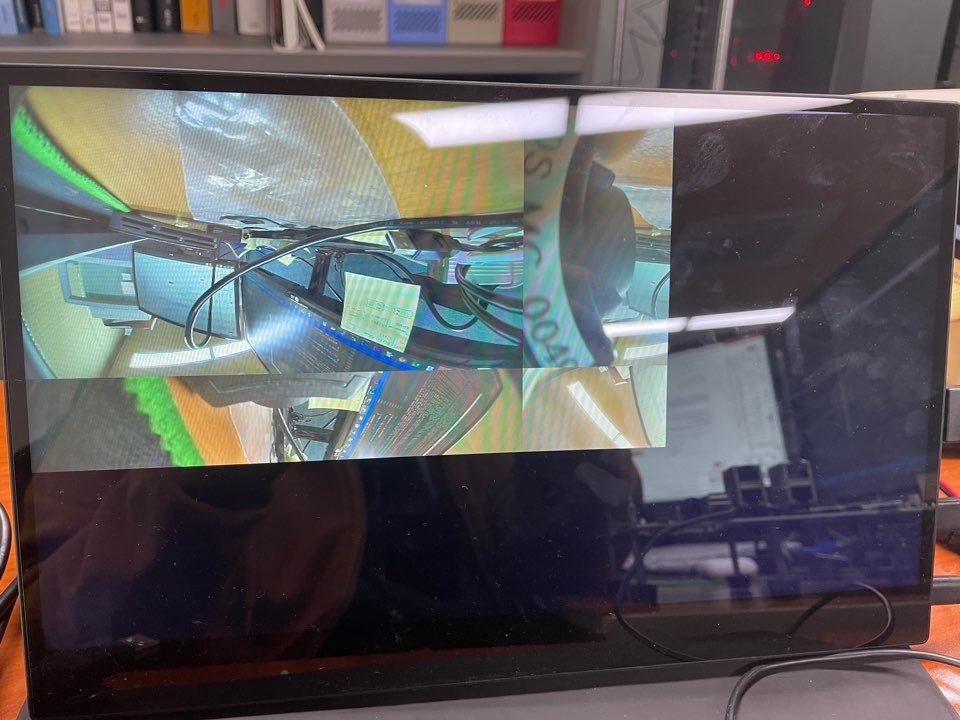

I am using PSDK 7.0 in TDA4VM EVM.
I want to change the display resolution from 1920x1080 to 1280x720.
I am currently using the graph app with the structure below.
Capture - LDC - ImgMosaic - Display
Capture: 1280x720 Input
In the ImgMosaic and Display settings, I changed DISPLAY_WIDTH/HEGITH from FHD to HD.
However, the display output is output to FHD and only areas of HD size are output. (The rest is black screen)
I solved it by changing the full display settings of TDA2x VSDK. But I'm not sure about the TDA4 PSDK.
