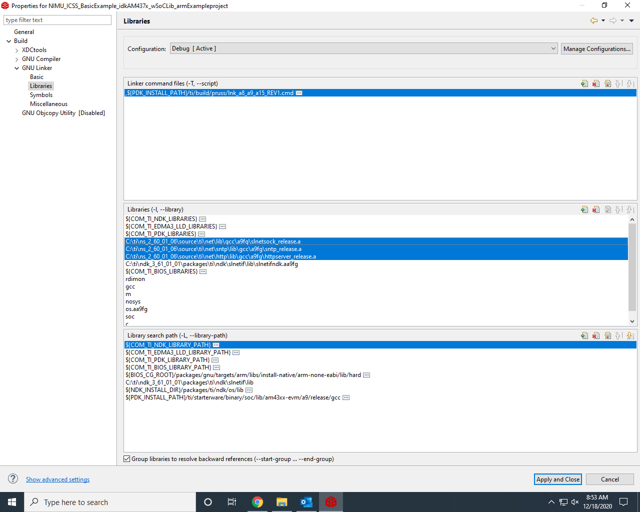

TMDSIDK437X: TI am437x HTTP
Part Number: TMDSIDK437X
I am trying to develop HTTP server for TIam437x on IDK437x.
below are my software component.
I have added http server related files from package path:C:\ti\ns_2_60_01_06\source\ti\net\http
httpserver.c, httpserver_send.c, httpserver_sleep.c, http.h, httpserver.h,logging.h,urlhandler.h.
I have also included library file for http server from package path:C:\ti\ns_2_60_01_06\source\ti\net\http\lib\gcc\a9fg
C:\ti\ns_2_60_01_06\source\ti\net\http\lib\gcc\a9fg.a.
I have added files from package path:C:\ti\ns_2_60_01_06\source\ti\net
slnetif.c, slnetsock.c, slnetutils.c, slneterr.h, slnetif.h, slnetsock.h,slnetutils.h
Lib file is also added from package path:C:\ti\ns_2_60_01_06\source\ti\net\lib\gcc\a9fg
slnetsock_release.a

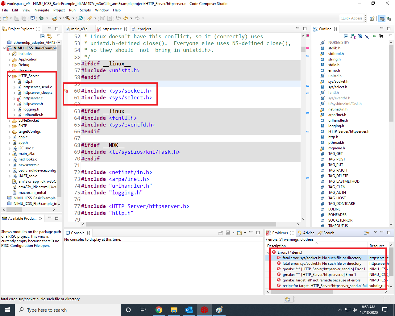

During compilation i am encountering problem as mentioned below.
Description Resource Path Location Type
fatal error: sys/socket.h: No such file or directory httpserver.c /NIMU_ICSS_BasicExample_idkAM437x_wSoCLib_armExampleproject/HTTP_Server line 60 C/C++ Problem
As per the ndk api guide provided with package: file:///C:/ti/ndk_3_61_01_01/docs/ndk/NDK_API_Reference.html#f.1-using-bsd-sockets-provided-by-slnetsock
F.1 Using BSD Sockets Provided by SlNetSock
i have added <SIMPLELINK_SDK_INSTALL_DIR>/source/ti/net/bsd to project directory.
kindly guide.
Vrund

  • Hi Vrund,
    It is fine to use HTTP server module in ns_2_60_01_06. The proper way to use it is to link the prebuilt library instead of adding source code to your project. Please follow chapter 3 HTTPServer from ns_2_60_01_06/docs/ns/NS_Users_Guide.html on how to write your application code.
    Please note that <sys/socket.h> is included in the API header file httpserver.h:
    #include <sys/socket.h>
    This may be a mistake as socket.h is not needed by httpserver.h. You can simply comment out this line, otherwise your application code won't compile.
    Jianzhong
    --- done.
    ---done.

    **** Build of configuration Debug for project NIMU_ICSS_BasicExample_idkAM437x_wSoCLib_armExampleproject ****
    "C:\\ti\\ccs930\\ccs\\utils\\bin\\gmake" -k -j 4 all -O
    Building file: "../app.c"
    Invoking: GNU Compiler
    "C:/ti/ccs930/ccs/tools/compiler/gcc-arm-none-eabi-7-2017-q4-major-win32/bin/arm-none-eabi-gcc-7.2.1.exe" -c -mcpu=cortex-a9 -march=armv7-a -mtune=cortex-a9 -marm -mfloat-abi=hard -Dam4379 -DUSE_BIOS -DSOC_AM437x -DidkAM437x -DSWITCH_EMAC -I"C:/Users/20033229/workspace_v9/NIMU_ICSS_BasicExample_idkAM437x_wSoCLib_armExampleproject" -I"C:/Users/20033229/workspace_v9/NIMU_ICSS_BasicExample_idkAM437x_wSoCLib_armExampleproject/Application/Backplane_Communication" -I"C:/Users/20033229/workspace_v9/NIMU_ICSS_BasicExample_idkAM437x_wSoCLib_armExampleproject/Application/Complogic" -I"C:/Users/20033229/workspace_v9/NIMU_ICSS_BasicExample_idkAM437x_wSoCLib_armExampleproject/Application/Configuration" -I"C:/Users/20033229/workspace_v9/NIMU_ICSS_BasicExample_idkAM437x_wSoCLib_armExampleproject/Application/Device_Monitoring_Functions" -I"C:/Users/20033229/workspace_v9/NIMU_ICSS_BasicExample_idkAM437x_wSoCLib_armExampleproject/Application/Metering" -I"C:/Users/20033229/workspace_v9/NIMU_ICSS_BasicExample_idkAM437x_wSoCLib_armExampleproject/Application/Modbus" -I"C:/Users/20033229/workspace_v9/NIMU_ICSS_BasicExample_idkAM437x_wSoCLib_armExampleproject/Application/Motor_ControlMonitoring" -I"C:/Users/20033229/workspace_v9/NIMU_ICSS_BasicExample_idkAM437x_wSoCLib_armExampleproject/Application/NVMemory_Module" -I"C:/Users/20033229/workspace_v9/NIMU_ICSS_BasicExample_idkAM437x_wSoCLib_armExampleproject/Application/PAL" -I"C:/Users/20033229/workspace_v9/NIMU_ICSS_BasicExample_idkAM437x_wSoCLib_armExampleproject/Application/Protection" -I"C:/Users/20033229/workspace_v9/NIMU_ICSS_BasicExample_idkAM437x_wSoCLib_armExampleproject/Application/Utilities" -I"C:/ti/ns_2_60_01_06/source/ti/net" -I"C:/ti/ns_2_60_01_06/source/ti/net/sntp" -I"C:/ti/ns_2_60_01_06/source/ti/net/http" -I"C:/ti/ndk_3_61_01_01/packages/ti/ndk/inc" -I"<SIMPLELINK_SDK_INSTALL_DIR>/source/ti/net/bsd" -I"C:/ti/ns_2_60_01_06/source" -I"C:/Users/20033229/workspace_v9/NIMU_ICSS_BasicExample_idkAM437x_wSoCLib_armExampleproject" -I"C:/ti/ccs930/ccs/tools/compiler/gcc-arm-none-eabi-7-2017-q4-major-win32/arm-none-eabi/include/newlib-nano" -I"C:/ti/ccs930/ccs/tools/compiler/gcc-arm-none-eabi-7-2017-q4-major-win32/arm-none-eabi/include" -Og -g -gdwarf-3 -gstrict-dwarf -Wall -c -MMD -MP -MMD -MP -MF"app.d" -MT"app.o" @"configPkg/compiler.opt" -o"app.o" "../app.c"

    Building target: "NIMU_ICSS_BasicExample_idkAM437x_wSoCLib_armExampleproject.out"
    Invoking: GNU Linker
    "C:/ti/ccs930/ccs/tools/compiler/gcc-arm-none-eabi-7-2017-q4-major-win32/bin/arm-none-eabi-gcc-7.2.1.exe" -mtune=cortex-a9 -marm -Dam4379 -DUSE_BIOS -DSOC_AM437x -DidkAM437x -DSWITCH_EMAC -Og -g -gdwarf-3 -gstrict-dwarf -Wall -MMD -MP -mfloat-abi=hard -Wl,-Map,"NIMU_ICSS_BasicExample_idkAM437x_wSoCLib_armExampleproject.map" -nostartfiles -Wl,--gc-sections -L"C:/ti/bios_6_76_03_01/packages/gnu/targets/arm/libs/install-native/arm-none-eabi/lib/hard" -L"C:/ti/ndk_3_61_01_01/packages/ti/ndk/slnetif/lib" -L"C:/ti/ndk_3_61_01_01/packages/ti/ndk/os/lib" -L"C:/ti/pdk_am437x_1_0_17/packages/ti/starterware/binary/soc/lib/am43xx-evm/a9/release/gcc" -L"C:/ti/ns_2_60_01_06/source/ti/net/http/lib/gcc/a9fg" -Wl,--defsym,STACKSIZE=0x18000 -Wl,--defsym,HEAPSIZE=0x400 --specs=nano.specs -static C:/ti/pdk_am437x_1_0_17/packages/MyExampleProjects/NIMU_ICSS_BasicExample_idkAM437x_wSoCLib_armExampleproject/../../ti/drv/icss_emac/firmware/icss_dualemac/bin/am437x/a9host/REV1/icss_dualemac_PRU0.bin C:/ti/pdk_am437x_1_0_17/packages/MyExampleProjects/NIMU_ICSS_BasicExample_idkAM437x_wSoCLib_armExampleproject/../../ti/drv/icss_emac/firmware/icss_dualemac/bin/am437x/a9host/REV1/icss_dualemac_PRU1.bin -o"NIMU_ICSS_BasicExample_idkAM437x_wSoCLib_armExampleproject.out" "./I2C_soc.o" "./UART_soc.o" "./app.o" "./main_a9.o" "./netHooks.o" "./newservers.o" "./osdrv_ndkdeviceconfig.o" "./Application/Backplane_Communication/Backplane_Communication.o" "./Application/Backplane_Communication/Backplane_QueryResponse.o" "./Application/Complogic/CompLogic.o" "./Application/Configuration/CONFIG_COMPLogicSettings.o" "./Application/Configuration/CONFIG_GeneralSettings.o" "./Application/Configuration/CONFIG_ProtectionSettings.o" "./Application/Configuration/Configuration.o" "./Application/Device_Monitoring_Functions/AIO.o" "./Application/Device_Monitoring_Functions/DIO.o" "./Application/Device_Monitoring_Functions/Diagnostic.o" "./Application/Device_Monitoring_Functions/Temperature.o" "./Application/Metering/metering.o" "./Application/Modbus/Modbus.o" "./Application/Modbus/Modbus_CoilRegister.o" "./Application/Modbus/Modbus_DiscretInputRegister.o" "./Application/Modbus/Modbus_HoldingRegister.o" "./Application/Modbus/Modbus_InputRegister.o" "./Application/Modbus/Modbus_UserDefinedFC.o" "./Application/Motor_ControlMonitoring/Motor_Commands.o" "./Application/Motor_ControlMonitoring/Motor_starters.o" "./Application/Motor_ControlMonitoring/Start_Stop_Logic.o" "./Application/NVMemory_Module/DataLogger.o" "./Application/NVMemory_Module/PowerDown.o" "./Application/PAL/PAL.o" "./Application/Protection/Protection.o" "./Application/Protection/Protection_Control.o" "./Application/Protection/Protection_Current.o" "./Application/Protection/Protection_Interlocks.o" "./Application/Protection/Protection_ThermalOverload.o" "./Application/Protection/Protection_Voltage.o" "./Application/Protection/Time_Over_Current.o" "./Application/Utilities/Utilities.o" "./SNTP/sntp.o" "./ftpserver/ftp_commands.o" "./ftpserver/ftp_filerout.o" "./ftpserver/ftpserver.o" -Wl,-T"configPkg/linker.cmd" -Wl,--start-group -Wl,-T",C:/ti/pdk_am437x_1_0_17/packages/ti/build/pruss/lnk_a8_a9_a15_REV1.cmd" "C:/ti/ns_2_60_01_06/source/ti/net/lib/gcc/a9fg/slnetsock_release.a" "C:/ti/ns_2_60_01_06/source/ti/net/sntp/lib/gcc/a9fg/sntp_release.a" "C:/ti/ndk_3_61_01_01/packages/ti/ndk/slnetif/lib/slnetifndk.aa9fg" "C:/ti/ns_2_60_01_06/source/ti/net/http/lib/gcc/a9fg/httpserver_release.a" -lrdimon -lgcc -lm -lnosys -l:os.aa9fg -lsoc -lc -Wl,--end-group
    makefile:221: recipe for target 'NIMU_ICSS_BasicExample_idkAM437x_wSoCLib_armExampleproject.out' failed
    ./app.o: In function `MyURLHandler_process':
    C:\Users\20033229\workspace_v9\NIMU_ICSS_BasicExample_idkAM437x_wSoCLib_armExampleproject\Debug/../app.c:209: undefined reference to `HTTPServer_SendResponse'
    collect2.exe: error: ld returned 1 exit status
    gmake[1]: *** [NIMU_ICSS_BasicExample_idkAM437x_wSoCLib_armExampleproject.out] Error 1
    makefile:217: recipe for target 'all' failed
    gmake: *** [all] Error 2
    **** Build Finished ****
    problem window:
    gmake: *** [all] Error 2 NIMU_ICSS_BasicExample_idkAM437x_wSoCLib_armExampleproject C/C++ Problem
    gmake[1]: *** [NIMU_ICSS_BasicExample_idkAM437x_wSoCLib_armExampleproject.out] Error 1 NIMU_ICSS_BasicExample_idkAM437x_wSoCLib_armExampleproject C/C++ Problem
    recipe for target 'all' failed makefile /NIMU_ICSS_BasicExample_idkAM437x_wSoCLib_armExampleproject/Debug line 217 C/C++ Problem
    recipe for target 'NIMU_ICSS_BasicExample_idkAM437x_wSoCLib_armExampleproject.out' failed makefile /NIMU_ICSS_BasicExample_idkAM437x_wSoCLib_armExampleproject/Debug line 221 C/C++ Problem
    undefined reference to `HTTPServer_SendResponse' app.c /NIMU_ICSS_BasicExample_idkAM437x_wSoCLib_armExampleproject line 209 C/C++ Problem
    I have linked the library file for http: from path:C:\ti\ns_2_60_01_06\source\ti\net\http\lib\gcc\a9fg\httpserver_release.a
    C:\ti\ns_2_60_01_06\source\ti\net\lib\gcc\a9fg\slnetsock_release.a
    C:\ti\ns_2_60_01_06\source\ti\net\sntp\lib\gcc\a9fg\sntp_release.a
    and this as well C:\ti\ndk_3_61_01_01\packages\ti\ndk\slnetif\lib\slnetifndk.aa9fg
    Vrund

    from C:/ti/pdk_am437x_1_0_17/packages/ti/transport/ndk/nimu_icss/example/src/osdrv_ndkdeviceconfig.h:47,
    from ../app.c:69:
    C:/ti/ndk_3_61_01_01/packages/ti/ndk/inc/nettools/inc/httpif.h:153:6: note: originally defined here
    enum HTTP_STATUS_CODE
    One question I have for you is: do you need both C:/ti/ndk_3_61_01_01/packages/ti/ndk/inc/netmain.h and C:/ti/ns_2_60_01_06/source/ti/net/http/http.h? If you don't need NDK header, you can simple remove it and this problem will be fixed.
    If you do need both headers, a solution is to modify C:/ti/ns_2_60_01_06/source/ti/net/http/http.h and rename HTTP_STATUS_CODE to something else. For example:
    enum NS_HTTP_STATUS_CODE {
    Hope this helps.
    Jianzhong
