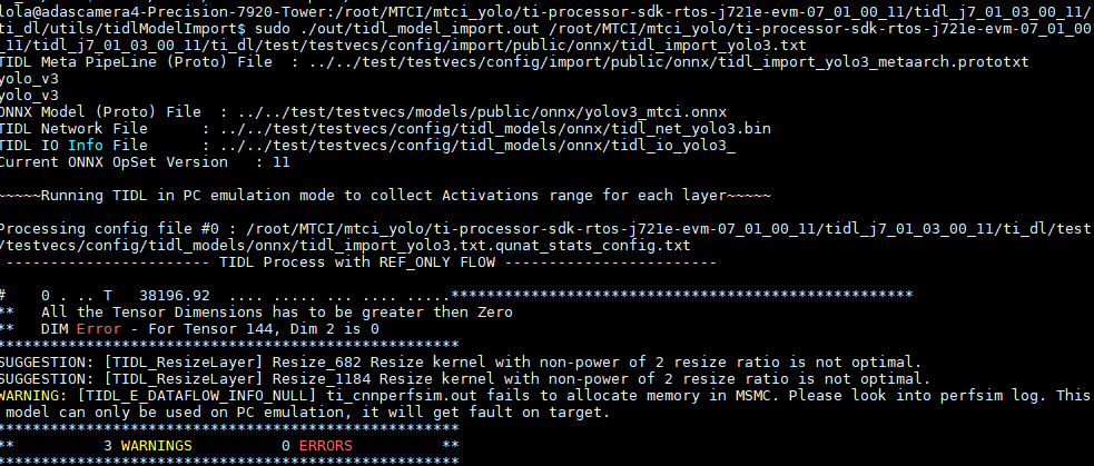

YOLOV3 Import:
What is the issue with the tensor details.

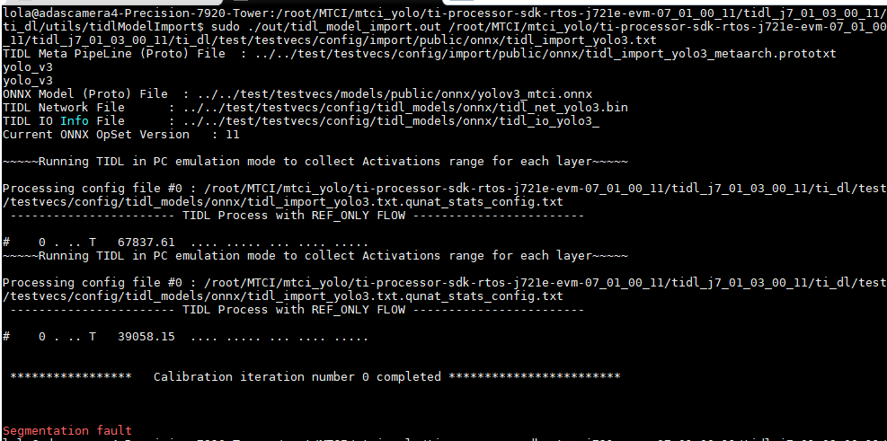

When the calibrationOption is set to 4/7 in configuration parameters "segmentation fault" is observed as below, What could be the reason?

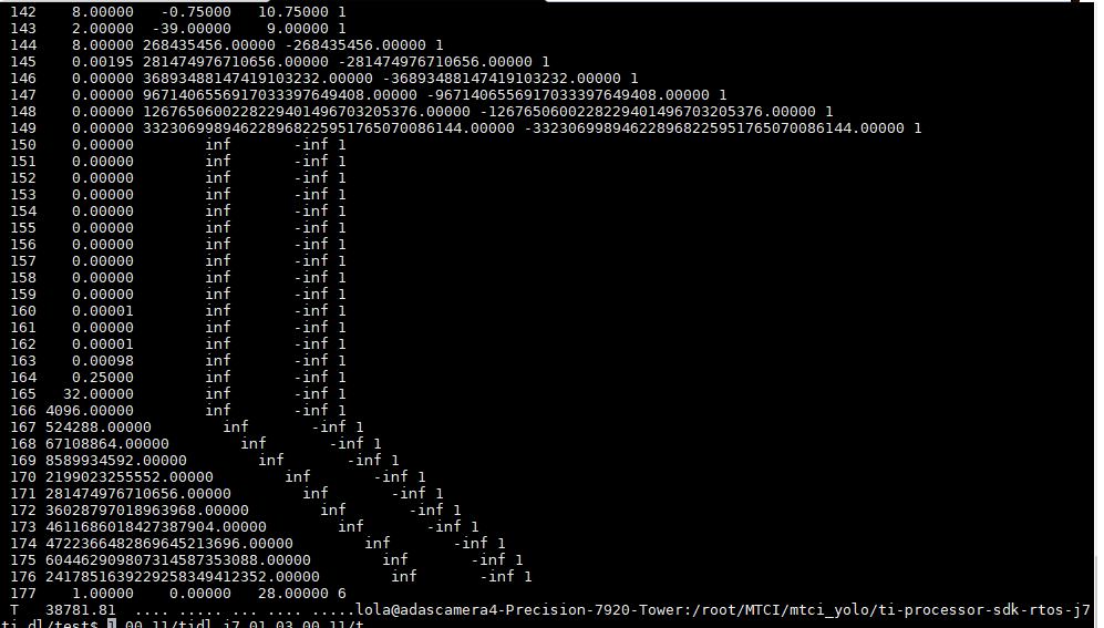

YOLOV3 Infer:
When i performed the feature map analysis the below values are observed can you explain the behaviour of layers 144 to 177?
