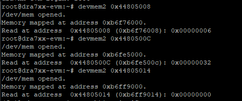

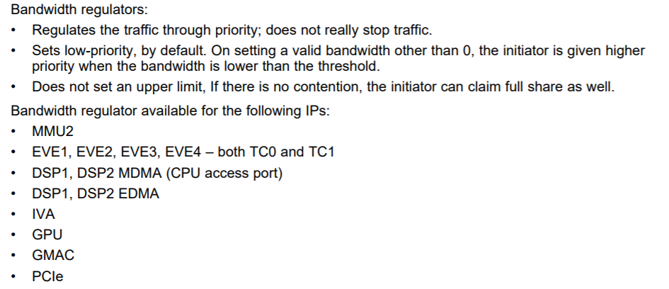

TDA2HG: Set IVA DDR bandwidth regulator but not valid
Part Number: TDA2HG
I'm visionSDK version: 3.08;
Now I need smooth IVA peak bandwidth, so I called "Utils_setBWRegulator(UTILS_DMM_INITIATOR_ID_IVA, 100)" in function "AppCtrl_setSystemL3DmmPri";
But it's bandwidth still jump to 600MB/s and 0MB/s.
Did I miss something? Thanks!
