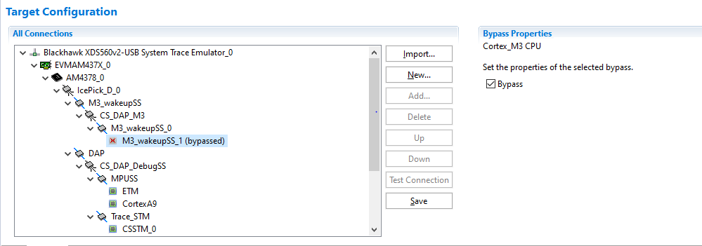

I am using a USB560 V2 Blackhawk emulator on the TMDEVM437x EVM board.
I try to debug in Code Composer v10.
I get the following error:
M3_wakeupSS_1: Trouble Halting Target CPU: (Error -1266 @ 0x0) Device is held in reset. Take the device out of reset, and retry the operation. (Emulation package 9.2.0.00002)
M3_wakeupSS_1: GEL: Target must be connected before calling the function
I can run the connection test and all looks good:

So I am stuck on what to do next.  Any help would be greatly appreciated.
Thank you.
