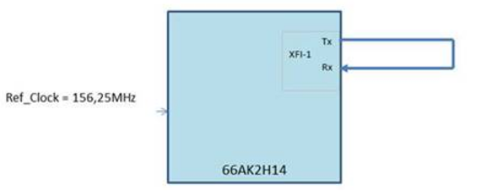

I am currently experimenting a very simple setup relative to XFI at 10Gb/s loopback :
This lab is OK and I am able to run all the 3 "serdes_diag" tools : "serdes_diag_PRBS", "serdes_diag_EyeDiagram" , and "serdes_diag_BER' .Everything is fine there.

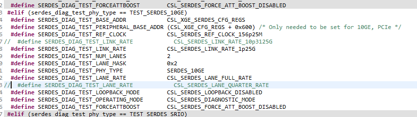

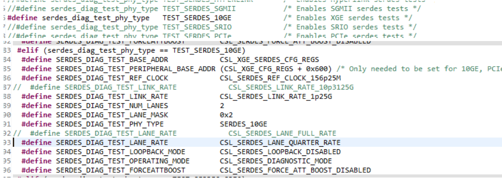

To do so I have modified the "serdes_diag_platform.h" file - for datarate itself (1p25G), and for lane rate as well (QUARTER_RATE) -
My new configuration; which I think is in accordance with the table11-1 from SPRUHO3A document, is the following :
These updates do not seem to be enough because none of the 3 serdes_diag tools is no more able to run till the end. All 3 tools are looping waiting for "CSL_SERDES_STATUS_PLL_LOCKED' ( function "CSL_Serdes_Deassert_Reset" from 'CSL_serdes2.h" file)

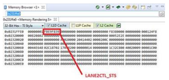

I also notice that (after pausing the SOC under CCS910 while looping) that the register "LANExCTL_STS" is not initialized in accordance to table 11-1 of SPRUHO3A requiring "Bit_width"=10 while this field appears to be equal to 16 bits.(same for Rx and Tx sides)
