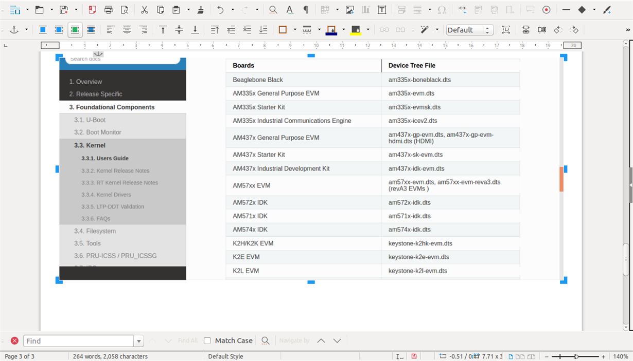

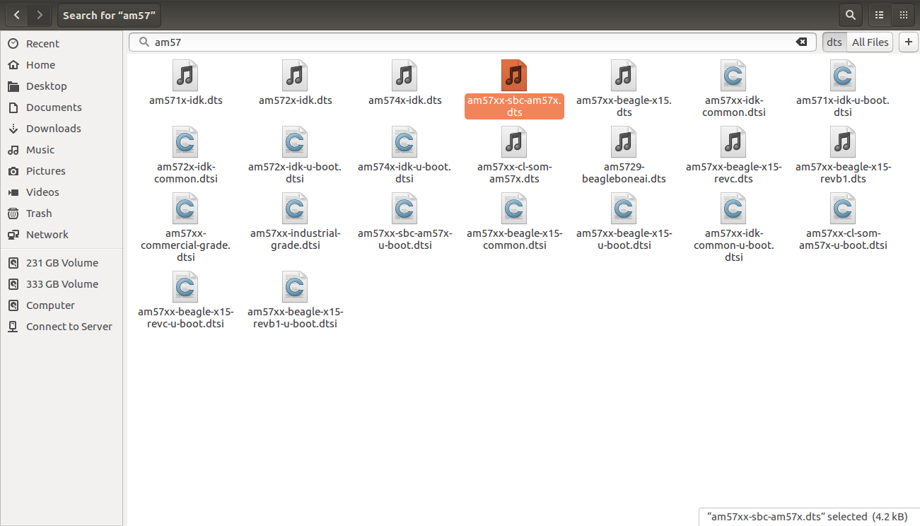

    5.Doubt1:So similar we are going for custom board based on AM57xx So in such case to create a dts file for my board i want a reference dts file where i didn't find any such only these files are present in u-boot/arch/arm/dts/
    6.Doubt2:My board is AM57xx-Evm right so which dts out of 2 mentioned name do i have to choose as mentioned in below pic.
    7.And Doubt3: As shown below i tried to get am57xx-evm.dts and am57xx-evm-rev3.dts from net directly but nothing is there in those files only boot selection information is present.
    I hope i explained you in clear manner about my doubt. So expecting some positive reply for this.

    anantha nagavidhyalavanya said:
    4.Now comes my doubt. Earlier for AM437x to create a custom board related dts file i taken reference of existed dts files in path as i mentioned in 1 step. Where in that dts file all pinmux information along with component information configuring component information exists.
    You should see am57xx-beagle-x15.dts.
    Now that file will have include files--> dtsi files you need to back track to the file that actually has pinmux files.
    am57xx-beagle-x15.dts-->am57xx-beagle-x15-common.dtsi-->dra74x-mmc-iodelay.dtsi
    You can see that dra74x-mmc-iodelay.dtsi file will have pinmux definitions.
    We have a tree structure of dt files and you just need to back track.
    Also one additional thing to note is that am57xx SoCs have IODelay feature so most of the pin muxing happens at u-boot:
    board/ti/am57xx/mux_data.h
    Please check that file as well.
    Similar to kernel: arch/arm/dts/am57xx-beagle-x15.dts
    arch/arm/dts/am57xx-beagle-x15-revc.dts or arch/arm/dts/am57xx-beagle-x15.dts based on your revision.
    Try arch/arm/dts/am57xx-beagle-x15-revc.dts.

  • Hi Anantha,
    Do you have an evm or IDK?
    If EVM the you are good with the above else if using IDK you can refer to am572x-idk.dts and back track as i explained by going back with dtsi files.
    Keerthy

  • Hi Lavanya,
    Just boot with the pre-built binaries to u-boot prompt.
    Run the below commands:
    run findfdt
    printenv fdtfile
    That will give you the exact dtb file that you need to load for your board.
