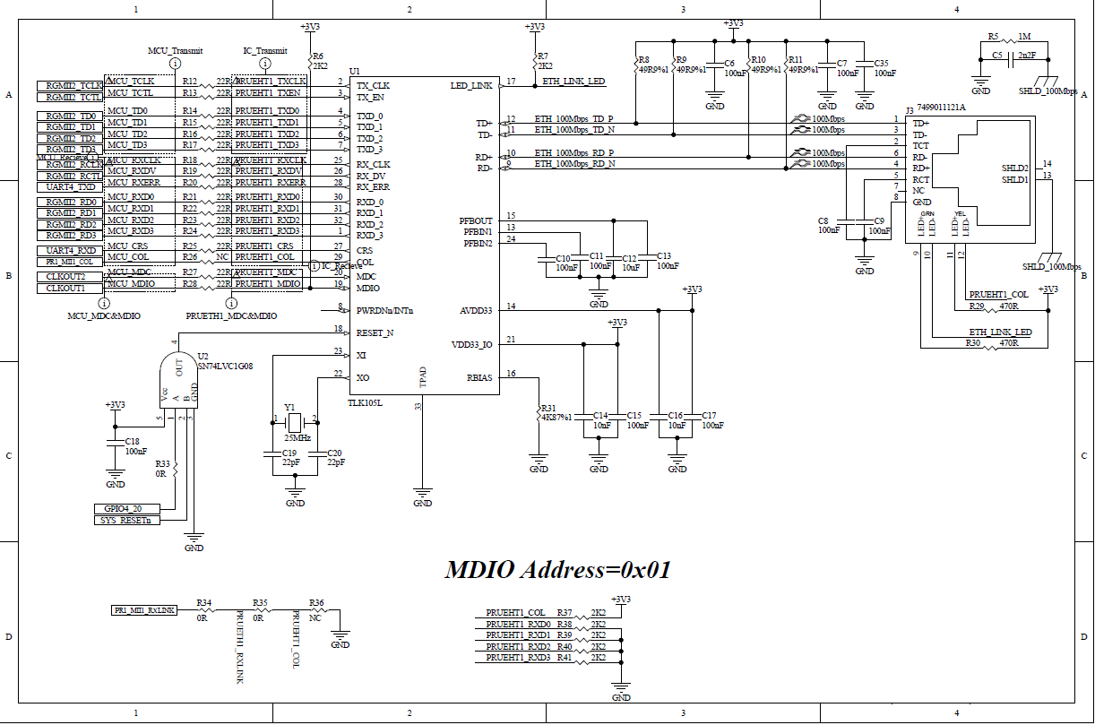

Hi ,
I am working on a custom AM437x board where i obtained MYD_C437x module, and a simple PCB design that includes 1 CPSW and  1 PRU ethernet ports.
As i did my research, i found out that the single PRU is supported after Lİnux SDK 5.3 or later, so i decided to use latest Linux RT SDK 6.03 (with linux-rt-4.19.94) rather than the one provided by 3rd party(4.1).
Referencing the topic: "https://e2e.ti.com/support/processors/f/791/t/854235?tisearch=e2e-sitesearch&keymatch=single%20pru%20am437x

What could be the reason for such error, i am using one TLK105L as PHY. (Same problem occurs when i work with idkam437, applied same dts changes in PRU-wise)
Thanks in advance!

    Hi, i am a bit lost and in a hurry here, and really appreciate you help,i am using TLK105L in MII mode.
    davinci_mdio 54432400.mdio: phy[1]: device 54432400.mdio:01, driver unknown problem persists.
    In my design, every pin is identically connected as it was in idkam437, the only difference is that i am using a crystal for the TLK105L. I am not even using a custom defconfig, using the once i compiled with your assist just to see eth1 go up properly, because it's my main problem, and the same defconfig works just fine with the MYIR PRU board, which is almost identical to idkam437x, and mine PRU-connections-wise.
    As i observed with an oscilloscope, the PWRDNn/INTn pin is always high and reset_n goes high during the boot-up, a square-wave on MDC, around 1MHz just as after reset_n goes high.
    The pins values as follows:
    PFBOUT : 1.68V
    PFBIN: 0.44V
    PFBIN2 : 0V
    RBIAS : 1.22V
    However there are anomalies such as:
    - No signal on neither XI nor XO.(I am using a 10uW crystal, so i placed a 25 Ohms limiting resistor) (tried connecting a 25Mhz signal generator and the boot-log is the same btw, seems like "unknown driver" has nothing to do with tlk105l's clock)

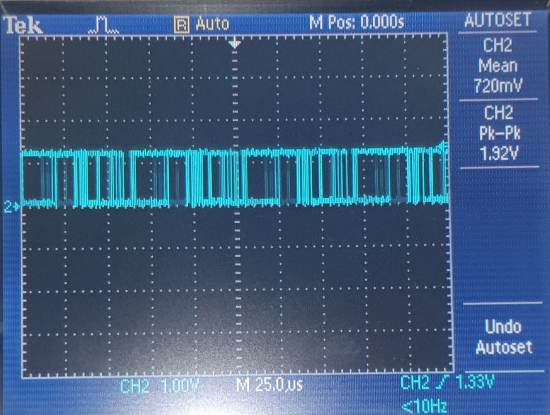

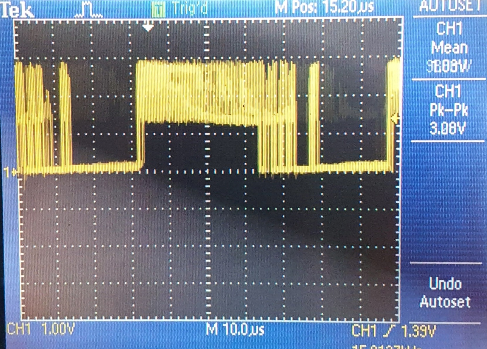

    - MDIO starts with the following signal (after reset_n goes high):
    Then morphs into this interesting, noisy periodic signal:
    I am not quiet sure the root of "unknown driver" error, the same zImage, same u-boot, and dts changes, works just fine both with idkam437x and myir's custom board, and my connections are identical.

    Is the TLK105 device capable of establishing link with a link partner? I am wondering if the PHY can boot into the correct mode and establish link and the issue is local to MDC/MDIO pins or there is a more fundamental problem? Is the current consumption what is expected?
    I do not see an issue with the schematic above. Another debugging step would be to use an external tool to access the PHY registers like an MSP430F5529LP launchpad and USB-2-MDIO tool and determine if the schematic and PHY can allow register access.

    Turns out  it was a schematics problem, where pins 13-15-24 should be short-circuited, changing it to DP83822 (where one can left them floating) should work.
    (Where i am not quiet sure that one must PD the 24, as they stated in many posts but not in the transition manual nor DP's datasheet...)
    Does that resolve the issue and allow registers to be read properly?
    Justin
  • Hi Justin
    Yes it does.
    However i am not quiet sure if i need to PD(with 2.2kOhm) the pin on 24 when i switch the PHY to DP83822...
    Datasheet states that it can be left floating if not used, however there are some posts that say one should pull it down otherwise it won't work: e2e.ti.com/.../748899
    I just wonder why is that, should i revise my PCB accordingly (or just swap the capacitor on 24 with a 2.2k ohm resistor)
    Thanks!
    The pin can be left floating if there are no external components connected to, e.g. it's not being used for an LED indicator. The internal pull-down of the pin will hold it in Mode 0 during bootstrapping. LED_1 needs to be either pulled up or down if there as the intermediate bootstrap threshold of Mode 1 or Mode 2 are internal test modes of the PHY. The safest thing would be to have an external strapping resistor connected to this pin.
    Justin
