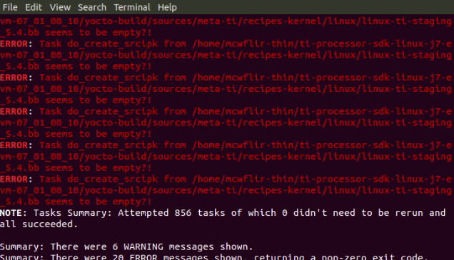

I am following this document for the Installation and building of Ti SDK. While building the SDK I have encountered some errors after executing this command
TOOLCHAIN_BASE=$HOME MACHINE=j7-evm bitbake -k tisdk-default-image
This is the snapshot of the error message
Can anyone tell me why this is happening?

  • Hi Kaviraj,
    Can you please copy paste (in text), the contents of the file /home/mcwflir-thin/ti-processor-sdk-linux-j7-evm-07_01_00_10/yocto-build/sources/meta-ti/recipes-kernel/linux/linux-ti-staging_5.4.bb?
    If this is empty, can you please check if you modified it, if yes restore to original version and retry?
    Karthik
  • Hi Karthik,
    The File that you have mentioned is not empty. I have attached the text file for your reference. Please find the attachment below

  • Hi Kaviraj,
    Thanks.
    1. Can you please send me the list of commands that you have run?
    2. Please share the full console log of output of the commands too.
    3. Can you also let me know if you have done any other changes on top of the base SDK?
    Karthik
  • Hi Karthik,
    I am following the Linux SDK documentation available on
    mcwflir-thin@mcwflir-thin:~/ti-processor-sdk-linux-j7-evm-07_01_00_10/yocto-build/build$ TOOLCHAIN_BASE=$HOME MACHINE=j7-evm bitbake -k tisdk-default-image

    Missing or unbuildable dependency chain was: ['libqt-embeddedmultimedia4']
    ERROR: Nothing RPROVIDES 'qt4-embedded-plugin-imageformat-jpeg' (but /home/mcwflir-thin/ti-processor-sdk-linux-j7-evm-07_01_00_10/yocto-build/sources/meta-arago/meta-arago-distro/recipes-core/packagegroups/packagegroup-arago-qte.bb RDEPENDS on or otherwise requires it)
    NOTE: Runtime target 'qt4-embedded-plugin-imageformat-jpeg' is unbuildable, removing...
    Missing or unbuildable dependency chain was: ['qt4-embedded-plugin-imageformat-jpeg']
    ERROR: Nothing RPROVIDES 'qt4-embedded' (but /home/mcwflir-thin/ti-processor-sdk-linux-j7-evm-07_01_00_10/yocto-build/sources/meta-arago/meta-arago-distro/recipes-core/packagegroups/packagegroup-arago-qte.bb RDEPENDS on or otherwise requires it)
    NOTE: Runtime target 'qt4-embedded' is unbuildable, removing...
    Missing or unbuildable dependency chain was: ['qt4-embedded']
    ERROR: Nothing RPROVIDES 'gstreamer1.0-libav' (but /home/mcwflir-thin/ti-processor-sdk-linux-j7-evm-07_01_00_10/yocto-build/sources/meta-arago/meta-arago-distro/recipes-core/packagegroups/packagegroup-arago-gst.bb RDEPENDS on or otherwise requires it)
    gstreamer1.0-libav was skipped: because it has a restricted license 'commercial'. Which is not whitelisted in LICENSE_FLAGS_WHITELIST
    NOTE: Runtime target 'gstreamer1.0-libav' is unbuildable, removing...
    Missing or unbuildable dependency chain was: ['gstreamer1.0-libav']
    NOTE: Runtime target 'packagegroup-arago-gst' is unbuildable, removing...
    Missing or unbuildable dependency chain was: ['packagegroup-arago-gst', 'gstreamer1.0-libav']
    NOTE: Runtime target 'packagegroup-arago-tisdk-multimedia' is unbuildable, removing...
    Missing or unbuildable dependency chain was: ['packagegroup-arago-tisdk-multimedia', 'packagegroup-arago-gst', 'gstreamer1.0-libav']
    ERROR: Nothing PROVIDES 'virtual/egl' (but /home/mcwflir-thin/ti-processor-sdk-linux-j7-evm-07_01_00_10/yocto-build/sources/oe-core/meta/recipes-graphics/cairo/cairo_1.16.0.bb DEPENDS on or otherwise requires it)
    ti-img-rogue-umlibs PROVIDES virtual/egl but was skipped: missing required machine feature 'gpu' (not in MACHINE_FEATURES)
    ti-img-rogue-umlibs PROVIDES virtual/egl but was skipped: PREFERRED_PROVIDER_virtual/egl set to mesa, not ti-img-rogue-umlibs
    ti-sgx-ddk-um PROVIDES virtual/egl but was skipped: missing required machine feature 'gpu' (not in MACHINE_FEATURES)
    ti-sgx-ddk-um PROVIDES virtual/egl but was skipped: PREFERRED_PROVIDER_virtual/egl set to mesa, not ti-sgx-ddk-um
    NOTE: Runtime target 'gtk+3-demo' is unbuildable, removing...
    Missing or unbuildable dependency chain was: ['gtk+3-demo', 'cairo', 'virtual/egl']
    NOTE: Runtime target 'packagegroup-arago-tisdk-gtk' is unbuildable, removing...
    Missing or unbuildable dependency chain was: ['packagegroup-arago-tisdk-gtk', 'gtk+3-demo', 'cairo', 'virtual/egl']
    NOTE: Runtime target 'gtk+3' is unbuildable, removing...
    Missing or unbuildable dependency chain was: ['gtk+3', 'cairo', 'virtual/egl']
    NOTE: Runtime target 'gtk+3-dev' is unbuildable, removing...
    Missing or unbuildable dependency chain was: ['gtk+3-dev', 'cairo', 'virtual/egl']
    NOTE: Runtime target 'gstreamer1.0-plugins-bad-meta' is unbuildable, removing...
    Missing or unbuildable dependency chain was: ['gstreamer1.0-plugins-bad-meta', 'pango', 'cairo', 'virtual/egl']
    NOTE: Runtime target 'gstreamer1.0-plugins-bad' is unbuildable, removing...
    Missing or unbuildable dependency chain was: ['gstreamer1.0-plugins-bad', 'pango', 'cairo', 'virtual/egl']
    NOTE: Runtime target 'gstreamer1.0-plugins-base-meta' is unbuildable, removing...
    Missing or unbuildable dependency chain was: ['gstreamer1.0-plugins-base-meta', 'pango', 'cairo', 'virtual/egl']
    NOTE: Runtime target 'gstreamer1.0-plugins-base' is unbuildable, removing...
    Missing or unbuildable dependency chain was: ['gstreamer1.0-plugins-base', 'pango', 'cairo', 'virtual/egl']
    NOTE: Runtime target 'pango' is unbuildable, removing...
    Missing or unbuildable dependency chain was: ['pango', 'cairo', 'virtual/egl']
    NOTE: Runtime target 'pango-dev' is unbuildable, removing...
    Missing or unbuildable dependency chain was: ['pango-dev', 'cairo', 'virtual/egl']
    NOTE: Runtime target 'python3-pygobject' is unbuildable, removing...
    Missing or unbuildable dependency chain was: ['python3-pygobject', 'cairo', 'virtual/egl']
    NOTE: Runtime target 'strace' is unbuildable, removing...
    Missing or unbuildable dependency chain was: ['strace', 'bluez5', 'python3-pygobject', 'cairo', 'virtual/egl']
    NOTE: Runtime target 'packagegroup-arago-console' is unbuildable, removing...
    Missing or unbuildable dependency chain was: ['packagegroup-arago-console', 'strace', 'bluez5', 'python3-pygobject', 'cairo', 'virtual/egl']
    NOTE: Runtime target 'packagegroup-core-tools-debug' is unbuildable, removing...
    Missing or unbuildable dependency chain was: ['packagegroup-core-tools-debug', 'strace', 'bluez5', 'python3-pygobject', 'cairo', 'virtual/egl']
    NOTE: Runtime target 'strace-dev' is unbuildable, removing...
    Missing or unbuildable dependency chain was: ['strace-dev', 'bluez5', 'python3-pygobject', 'cairo', 'virtual/egl']
    NOTE: Runtime target 'pulseaudio-misc' is unbuildable, removing...
    Missing or unbuildable dependency chain was: ['pulseaudio-misc', 'bluez5', 'python3-pygobject', 'cairo', 'virtual/egl']
    NOTE: Runtime target 'ti-test' is unbuildable, removing...
    Missing or unbuildable dependency chain was: ['ti-test', 'pulseaudio-misc', 'bluez5', 'python3-pygobject', 'cairo', 'virtual/egl']
    NOTE: Runtime target 'pulseaudio-server' is unbuildable, removing...
    Missing or unbuildable dependency chain was: ['pulseaudio-server', 'bluez5', 'python3-pygobject', 'cairo', 'virtual/egl']
    NOTE: Runtime target 'packagegroup-arago-tisdk-connectivity' is unbuildable, removing...
    Missing or unbuildable dependency chain was: ['packagegroup-arago-tisdk-connectivity', 'pulseaudio-server', 'bluez5', 'python3-pygobject', 'cairo', 'virtual/egl']
    NOTE: Runtime target 'pulseaudio-module-bluez5-device' is unbuildable, removing...
    Missing or unbuildable dependency chain was: ['pulseaudio-module-bluez5-device', 'bluez5', 'python3-pygobject', 'cairo', 'virtual/egl']
    NOTE: Runtime target 'pulseaudio-module-bluetooth-policy' is unbuildable, removing...
    Missing or unbuildable dependency chain was: ['pulseaudio-module-bluetooth-policy', 'bluez5', 'python3-pygobject', 'cairo', 'virtual/egl']
    NOTE: Runtime target 'pulseaudio-module-loopback' is unbuildable, removing...
    Missing or unbuildable dependency chain was: ['pulseaudio-module-loopback', 'bluez5', 'python3-pygobject', 'cairo', 'virtual/egl']
    NOTE: Runtime target 'pulseaudio-module-bluetooth-discover' is unbuildable, removing...
    Missing or unbuildable dependency chain was: ['pulseaudio-module-bluetooth-discover', 'bluez5', 'python3-pygobject', 'cairo', 'virtual/egl']
    NOTE: Runtime target 'pulseaudio-lib-bluez5-util' is unbuildable, removing...
    Missing or unbuildable dependency chain was: ['pulseaudio-lib-bluez5-util', 'bluez5', 'python3-pygobject', 'cairo', 'virtual/egl']
    NOTE: Runtime target 'pulseaudio-module-bluez5-discover' is unbuildable, removing...
    Missing or unbuildable dependency chain was: ['pulseaudio-module-bluez5-discover', 'bluez5', 'python3-pygobject', 'cairo', 'virtual/egl']
    NOTE: Runtime target 'pulseaudio' is unbuildable, removing...
    Missing or unbuildable dependency chain was: ['pulseaudio', 'bluez5', 'python3-pygobject', 'cairo', 'virtual/egl']
    NOTE: Runtime target 'pulseaudio-module-detect' is unbuildable, removing...
    Missing or unbuildable dependency chain was: ['pulseaudio-module-detect', 'bluez5', 'python3-pygobject', 'cairo', 'virtual/egl']
    NOTE: Runtime target 'pulseaudio-module-alsa-source' is unbuildable, removing...
    Missing or unbuildable dependency chain was: ['pulseaudio-module-alsa-source', 'bluez5', 'python3-pygobject', 'cairo', 'virtual/egl']
    NOTE: Runtime target 'pulseaudio-module-alsa-card' is unbuildable, removing...
    Missing or unbuildable dependency chain was: ['pulseaudio-module-alsa-card', 'bluez5', 'python3-pygobject', 'cairo', 'virtual/egl']
    NOTE: Runtime target 'pulseaudio-module-role-cork' is unbuildable, removing...
    Missing or unbuildable dependency chain was: ['pulseaudio-module-role-cork', 'bluez5', 'python3-pygobject', 'cairo', 'virtual/egl']
    NOTE: Runtime target 'pulseaudio-module-console-kit' is unbuildable, removing...
    Missing or unbuildable dependency chain was: ['pulseaudio-module-console-kit', 'bluez5', 'python3-pygobject', 'cairo', 'virtual/egl']
    NOTE: Runtime target 'pulseaudio-module-position-event-sounds' is unbuildable, removing...
    Missing or unbuildable dependency chain was: ['pulseaudio-module-position-event-sounds', 'bluez5', 'python3-pygobject', 'cairo', 'virtual/egl']
    NOTE: Runtime target 'pulseaudio-module-cli-protocol-unix' is unbuildable, removing...
    Missing or unbuildable dependency chain was: ['pulseaudio-module-cli-protocol-unix', 'bluez5', 'python3-pygobject', 'cairo', 'virtual/egl']
    NOTE: Runtime target 'pulseaudio-module-x11-publish' is unbuildable, removing...
    Missing or unbuildable dependency chain was: ['pulseaudio-module-x11-publish', 'bluez5', 'python3-pygobject', 'cairo', 'virtual/egl']
    NOTE: Runtime target 'pulseaudio-module-always-sink' is unbuildable, removing...
    Missing or unbuildable dependency chain was: ['pulseaudio-module-always-sink', 'bluez5', 'python3-pygobject', 'cairo', 'virtual/egl']
    NOTE: Runtime target 'pulseaudio-module-filter-heuristics' is unbuildable, removing...
    Missing or unbuildable dependency chain was: ['pulseaudio-module-filter-heuristics', 'bluez5', 'python3-pygobject', 'cairo', 'virtual/egl']
    NOTE: Runtime target 'pulseaudio-module-suspend-on-idle' is unbuildable, removing...
    Missing or unbuildable dependency chain was: ['pulseaudio-module-suspend-on-idle', 'bluez5', 'python3-pygobject', 'cairo', 'virtual/egl']
    NOTE: Runtime target 'pulseaudio-module-device-restore' is unbuildable, removing...
    Missing or unbuildable dependency chain was: ['pulseaudio-module-device-restore', 'bluez5', 'python3-pygobject', 'cairo', 'virtual/egl']
    NOTE: Runtime target 'pulseaudio-module-default-device-restore' is unbuildable, removing...
    Missing or unbuildable dependency chain was: ['pulseaudio-module-default-device-restore', 'bluez5', 'python3-pygobject', 'cairo', 'virtual/egl']
    NOTE: Runtime target 'pulseaudio-module-x11-xsmp' is unbuildable, removing...
    Missing or unbuildable dependency chain was: ['pulseaudio-module-x11-xsmp', 'bluez5', 'python3-pygobject', 'cairo', 'virtual/egl']
    NOTE: Runtime target 'pulseaudio-module-augment-properties' is unbuildable, removing...
    Missing or unbuildable dependency chain was: ['pulseaudio-module-augment-properties', 'bluez5', 'python3-pygobject', 'cairo', 'virtual/egl']
    NOTE: Runtime target 'pulseaudio-module-device-manager' is unbuildable, removing...
    Missing or unbuildable dependency chain was: ['pulseaudio-module-device-manager', 'bluez5', 'python3-pygobject', 'cairo', 'virtual/egl']
    NOTE: Runtime target 'pulseaudio-module-null-sink' is unbuildable, removing...
    Missing or unbuildable dependency chain was: ['pulseaudio-module-null-sink', 'bluez5', 'python3-pygobject', 'cairo', 'virtual/egl']
    NOTE: Runtime target 'pulseaudio-module-alsa-sink' is unbuildable, removing...
    Missing or unbuildable dependency chain was: ['pulseaudio-module-alsa-sink', 'bluez5', 'python3-pygobject', 'cairo', 'virtual/egl']
    NOTE: Runtime target 'pulseaudio-module-filter-apply' is unbuildable, removing...
    Missing or unbuildable dependency chain was: ['pulseaudio-module-filter-apply', 'bluez5', 'python3-pygobject', 'cairo', 'virtual/egl']
    NOTE: Runtime target 'pulseaudio-module-udev-detect' is unbuildable, removing...
    Missing or unbuildable dependency chain was: ['pulseaudio-module-udev-detect', 'bluez5', 'python3-pygobject', 'cairo', 'virtual/egl']
    NOTE: Runtime target 'pulseaudio-module-switch-on-port-available' is unbuildable, removing...
    Missing or unbuildable dependency chain was: ['pulseaudio-module-switch-on-port-available', 'bluez5', 'python3-pygobject', 'cairo', 'virtual/egl']
    NOTE: Runtime target 'pulseaudio-module-rescue-streams' is unbuildable, removing...
    Missing or unbuildable dependency chain was: ['pulseaudio-module-rescue-streams', 'bluez5', 'python3-pygobject', 'cairo', 'virtual/egl']
    NOTE: Runtime target 'pulseaudio-module-x11-cork-request' is unbuildable, removing...
    Missing or unbuildable dependency chain was: ['pulseaudio-module-x11-cork-request', 'bluez5', 'python3-pygobject', 'cairo', 'virtual/egl']
    NOTE: Runtime target 'pulseaudio-module-intended-roles' is unbuildable, removing...
    Missing or unbuildable dependency chain was: ['pulseaudio-module-intended-roles', 'bluez5', 'python3-pygobject', 'cairo', 'virtual/egl']
    NOTE: Runtime target 'pulseaudio-module-native-protocol-unix' is unbuildable, removing...
    Missing or unbuildable dependency chain was: ['pulseaudio-module-native-protocol-unix', 'bluez5', 'python3-pygobject', 'cairo', 'virtual/egl']
    NOTE: Runtime target 'pulseaudio-dev' is unbuildable, removing...
    Missing or unbuildable dependency chain was: ['pulseaudio-dev', 'bluez5', 'python3-pygobject', 'cairo', 'virtual/egl']
    NOTE: Runtime target 'pulseaudio-module-card-restore' is unbuildable, removing...
    Missing or unbuildable dependency chain was: ['pulseaudio-module-card-restore', 'bluez5', 'python3-pygobject', 'cairo', 'virtual/egl']
    NOTE: Runtime target 'pulseaudio-module-stream-restore' is unbuildable, removing...
    Missing or unbuildable dependency chain was: ['pulseaudio-module-stream-restore', 'bluez5', 'python3-pygobject', 'cairo', 'virtual/egl']
    NOTE: Runtime target 'tcpdump' is unbuildable, removing...
    Missing or unbuildable dependency chain was: ['tcpdump', 'libpcap', 'bluez5', 'python3-pygobject', 'cairo', 'virtual/egl']
    NOTE: Runtime target 'tcpdump-dev' is unbuildable, removing...
    Missing or unbuildable dependency chain was: ['tcpdump-dev', 'libpcap', 'bluez5', 'python3-pygobject', 'cairo', 'virtual/egl']
    NOTE: Runtime target 'ptpd' is unbuildable, removing...
    Missing or unbuildable dependency chain was: ['ptpd', 'libpcap', 'bluez5', 'python3-pygobject', 'cairo', 'virtual/egl']
    NOTE: Runtime target 'packagegroup-arago-tisdk-addons' is unbuildable, removing...
    Missing or unbuildable dependency chain was: ['packagegroup-arago-tisdk-addons', 'ptpd', 'libpcap', 'bluez5', 'python3-pygobject', 'cairo', 'virtual/egl']
    NOTE: Runtime target 'packagegroup-arago-tisdk-addons-extra' is unbuildable, removing...
    Missing or unbuildable dependency chain was: ['packagegroup-arago-tisdk-addons-extra', 'ptpd', 'libpcap', 'bluez5', 'python3-pygobject', 'cairo', 'virtual/egl']
    NOTE: Runtime target 'ptpd-dev' is unbuildable, removing...
    Missing or unbuildable dependency chain was: ['ptpd-dev', 'libpcap', 'bluez5', 'python3-pygobject', 'cairo', 'virtual/egl']
    NOTE: Runtime target 'libpcap-dev' is unbuildable, removing...
    Missing or unbuildable dependency chain was: ['libpcap-dev', 'bluez5', 'python3-pygobject', 'cairo', 'virtual/egl']
    NOTE: Runtime target 'libpcap' is unbuildable, removing...
    Missing or unbuildable dependency chain was: ['libpcap', 'bluez5', 'python3-pygobject', 'cairo', 'virtual/egl']
    NOTE: Runtime target 'ofono' is unbuildable, removing...
    Missing or unbuildable dependency chain was: ['ofono', 'bluez5', 'python3-pygobject', 'cairo', 'virtual/egl']
    NOTE: Runtime target 'packagegroup-base-zeroconf' is unbuildable, removing...
    Missing or unbuildable dependency chain was: ['packagegroup-base-zeroconf', 'ofono', 'bluez5', 'python3-pygobject', 'cairo', 'virtual/egl']
    NOTE: Runtime target 'packagegroup-base-vfat' is unbuildable, removing...
    Missing or unbuildable dependency chain was: ['packagegroup-base-vfat', 'ofono', 'bluez5', 'python3-pygobject', 'cairo', 'virtual/egl']
    NOTE: Runtime target 'packagegroup-machine-base' is unbuildable, removing...
    Missing or unbuildable dependency chain was: ['packagegroup-machine-base', 'ofono', 'bluez5', 'python3-pygobject', 'cairo', 'virtual/egl']
    NOTE: Runtime target 'packagegroup-base-pci' is unbuildable, removing...
    Missing or unbuildable dependency chain was: ['packagegroup-base-pci', 'ofono', 'bluez5', 'python3-pygobject', 'cairo', 'virtual/egl']
    NOTE: Runtime target 'packagegroup-base-wifi' is unbuildable, removing...
    Missing or unbuildable dependency chain was: ['packagegroup-base-wifi', 'ofono', 'bluez5', 'python3-pygobject', 'cairo', 'virtual/egl']
    NOTE: Runtime target 'packagegroup-base' is unbuildable, removing...
    Missing or unbuildable dependency chain was: ['packagegroup-base', 'ofono', 'bluez5', 'python3-pygobject', 'cairo', 'virtual/egl']
    NOTE: Runtime target 'packagegroup-base-alsa' is unbuildable, removing...
    Missing or unbuildable dependency chain was: ['packagegroup-base-alsa', 'ofono', 'bluez5', 'python3-pygobject', 'cairo', 'virtual/egl']
    NOTE: Runtime target 'packagegroup-base-ext2' is unbuildable, removing...
    Missing or unbuildable dependency chain was: ['packagegroup-base-ext2', 'ofono', 'bluez5', 'python3-pygobject', 'cairo', 'virtual/egl']
    NOTE: Runtime target 'packagegroup-base-3g' is unbuildable, removing...
    Missing or unbuildable dependency chain was: ['packagegroup-base-3g', 'ofono', 'bluez5', 'python3-pygobject', 'cairo', 'virtual/egl']
    NOTE: Runtime target 'packagegroup-base-bluetooth' is unbuildable, removing...
    Missing or unbuildable dependency chain was: ['packagegroup-base-bluetooth', 'ofono', 'bluez5', 'python3-pygobject', 'cairo', 'virtual/egl']
    NOTE: Runtime target 'packagegroup-distro-base' is unbuildable, removing...
    Missing or unbuildable dependency chain was: ['packagegroup-distro-base', 'ofono', 'bluez5', 'python3-pygobject', 'cairo', 'virtual/egl']
    NOTE: Runtime target 'packagegroup-base-usbgadget' is unbuildable, removing...
    Missing or unbuildable dependency chain was: ['packagegroup-base-usbgadget', 'ofono', 'bluez5', 'python3-pygobject', 'cairo', 'virtual/egl']
    NOTE: Runtime target 'packagegroup-base-nfs' is unbuildable, removing...
    Missing or unbuildable dependency chain was: ['packagegroup-base-nfs', 'ofono', 'bluez5', 'python3-pygobject', 'cairo', 'virtual/egl']
    NOTE: Runtime target 'packagegroup-base-nfc' is unbuildable, removing...
    Missing or unbuildable dependency chain was: ['packagegroup-base-nfc', 'ofono', 'bluez5', 'python3-pygobject', 'cairo', 'virtual/egl']
    NOTE: Runtime target 'packagegroup-base-apm' is unbuildable, removing...
    Missing or unbuildable dependency chain was: ['packagegroup-base-apm', 'ofono', 'bluez5', 'python3-pygobject', 'cairo', 'virtual/egl']
    NOTE: Runtime target 'packagegroup-base-ipv6' is unbuildable, removing...
    Missing or unbuildable dependency chain was: ['packagegroup-base-ipv6', 'ofono', 'bluez5', 'python3-pygobject', 'cairo', 'virtual/egl']
    NOTE: Runtime target 'packagegroup-base-usbhost' is unbuildable, removing...
    Missing or unbuildable dependency chain was: ['packagegroup-base-usbhost', 'ofono', 'bluez5', 'python3-pygobject', 'cairo', 'virtual/egl']
    NOTE: Runtime target 'ofono-dev' is unbuildable, removing...
    Missing or unbuildable dependency chain was: ['ofono-dev', 'bluez5', 'python3-pygobject', 'cairo', 'virtual/egl']
    NOTE: Runtime target 'bluez5-obex' is unbuildable, removing...
    Missing or unbuildable dependency chain was: ['bluez5-obex', 'python3-pygobject', 'cairo', 'virtual/egl']
    NOTE: Runtime target 'bluez5-testtools' is unbuildable, removing...
    Missing or unbuildable dependency chain was: ['bluez5-testtools', 'python3-pygobject', 'cairo', 'virtual/egl']
    NOTE: Runtime target 'bluez5' is unbuildable, removing...
    Missing or unbuildable dependency chain was: ['bluez5', 'python3-pygobject', 'cairo', 'virtual/egl']
    NOTE: Runtime target 'neard' is unbuildable, removing...
    Missing or unbuildable dependency chain was: ['neard', 'bluez5', 'python3-pygobject', 'cairo', 'virtual/egl']
    NOTE: Runtime target 'bluez5-noinst-tools' is unbuildable, removing...
    Missing or unbuildable dependency chain was: ['bluez5-noinst-tools', 'python3-pygobject', 'cairo', 'virtual/egl']
    NOTE: Runtime target 'bluez5-dev' is unbuildable, removing...
    Missing or unbuildable dependency chain was: ['bluez5-dev', 'python3-pygobject', 'cairo', 'virtual/egl']
    NOTE: Runtime target 'gstreamer1.0-plugins-good-meta' is unbuildable, removing...
    Missing or unbuildable dependency chain was: ['gstreamer1.0-plugins-good-meta', 'cairo', 'virtual/egl']
    NOTE: Runtime target 'gstreamer1.0-plugins-good' is unbuildable, removing...
    Missing or unbuildable dependency chain was: ['gstreamer1.0-plugins-good', 'cairo', 'virtual/egl']
    NOTE: Runtime target 'cairo' is unbuildable, removing...
    Missing or unbuildable dependency chain was: ['cairo', 'virtual/egl']
    NOTE: Runtime target 'cairo-dev' is unbuildable, removing...
    Missing or unbuildable dependency chain was: ['cairo-dev', 'virtual/egl']
    ERROR: Nothing PROVIDES 'virtual/libgles2' (but /home/mcwflir-thin/ti-processor-sdk-linux-j7-evm-07_01_00_10/yocto-build/sources/oe-core/meta/recipes-graphics/cairo/cairo_1.16.0.bb DEPENDS on or otherwise requires it)
    ti-img-rogue-umlibs PROVIDES virtual/libgles2 but was skipped: missing required machine feature 'gpu' (not in MACHINE_FEATURES)
    ti-img-rogue-umlibs PROVIDES virtual/libgles2 but was skipped: PREFERRED_PROVIDER_virtual/egl set to mesa, not ti-img-rogue-umlibs
    ti-sgx-ddk-um PROVIDES virtual/libgles2 but was skipped: missing required machine feature 'gpu' (not in MACHINE_FEATURES)
    ti-sgx-ddk-um PROVIDES virtual/libgles2 but was skipped: PREFERRED_PROVIDER_virtual/egl set to mesa, not ti-sgx-ddk-um
    ERROR: Nothing PROVIDES 'pulseaudio' (but /home/mcwflir-thin/ti-processor-sdk-linux-j7-evm-07_01_00_10/yocto-build/sources/oe-core/meta/recipes-multimedia/alsa/alsa-plugins_1.2.1.bb, /home/mcwflir-thin/ti-processor-sdk-linux-j7-evm-07_01_00_10/yocto-build/sources/oe-core/meta/recipes-multimedia/gstreamer/gstreamer1.0-plugins-good_1.16.3.bb DEPENDS on or otherwise requires it)
    No eligible PROVIDERs exist for 'pulseaudio'
    NOTE: Runtime target 'alsa-plugins-pulseaudio-conf' is unbuildable, removing...
    Missing or unbuildable dependency chain was: ['alsa-plugins-pulseaudio-conf', 'pulseaudio']
    ERROR: Nothing PROVIDES 'gstreamer1.0-plugins-base' (but /home/mcwflir-thin/ti-processor-sdk-linux-j7-evm-07_01_00_10/yocto-build/sources/oe-core/meta/recipes-multimedia/gstreamer/gstreamer1.0-plugins-bad_1.16.3.bb, /home/mcwflir-thin/ti-processor-sdk-linux-j7-evm-07_01_00_10/yocto-build/sources/oe-core/meta/recipes-multimedia/gstreamer/gstreamer1.0-plugins-good_1.16.3.bb DEPENDS on or otherwise requires it)
    No eligible PROVIDERs exist for 'gstreamer1.0-plugins-base'
    ERROR: Nothing PROVIDES 'faad2' (but /home/mcwflir-thin/ti-processor-sdk-linux-j7-evm-07_01_00_10/yocto-build/sources/oe-core/meta/recipes-multimedia/gstreamer/gstreamer1.0-plugins-bad_1.16.3.bb DEPENDS on or otherwise requires it)
    faad2 was skipped: because it has a restricted license 'commercial'. Which is not whitelisted in LICENSE_FLAGS_WHITELIST
    NOTE: Multiple providers are available for runtime wpa-supplicant-passphrase (wpa-supplicant, wpa-supplicant-wl18xx)
    Consider defining a PREFERRED_RPROVIDER entry to match wpa-supplicant-passphrase
    NOTE: Multiple providers are available for runtime wpa-supplicant-cli (wpa-supplicant, wpa-supplicant-wl18xx)
    Consider defining a PREFERRED_RPROVIDER entry to match wpa-supplicant-cli
    ERROR: Nothing RPROVIDES 'neard-dev' (but /home/mcwflir-thin/ti-processor-sdk-linux-j7-evm-07_01_00_10/yocto-build/sources/oe-core/meta/recipes-connectivity/neard/neard_0.16.bb RDEPENDS on or otherwise requires it)
    No eligible RPROVIDERs exist for 'neard-dev'
    NOTE: Runtime target 'neard-dev' is unbuildable, removing...
    Missing or unbuildable dependency chain was: ['neard-dev']
    ERROR: Nothing RPROVIDES 'alsa-plugins' (but /home/mcwflir-thin/ti-processor-sdk-linux-j7-evm-07_01_00_10/yocto-build/sources/oe-core/meta/recipes-multimedia/alsa/alsa-plugins_1.2.1.bb RDEPENDS on or otherwise requires it)
    No eligible RPROVIDERs exist for 'alsa-plugins'
    NOTE: Runtime target 'alsa-plugins' is unbuildable, removing...
    Missing or unbuildable dependency chain was: ['alsa-plugins']
    ERROR: Nothing RPROVIDES 'alsa-plugins-dev' (but /home/mcwflir-thin/ti-processor-sdk-linux-j7-evm-07_01_00_10/yocto-build/sources/oe-core/meta/recipes-multimedia/alsa/alsa-plugins_1.2.1.bb RDEPENDS on or otherwise requires it)
    No eligible RPROVIDERs exist for 'alsa-plugins-dev'
    NOTE: Runtime target 'alsa-plugins-dev' is unbuildable, removing...
    Missing or unbuildable dependency chain was: ['alsa-plugins-dev']
    ERROR: Nothing RPROVIDES 'libasound-module-pcm-pulse' (but /home/mcwflir-thin/ti-processor-sdk-linux-j7-evm-07_01_00_10/yocto-build/sources/oe-core/meta/recipes-multimedia/alsa/alsa-plugins_1.2.1.bb RDEPENDS on or otherwise requires it)
    No eligible RPROVIDERs exist for 'libasound-module-pcm-pulse'
    NOTE: Runtime target 'libasound-module-pcm-pulse' is unbuildable, removing...
    Missing or unbuildable dependency chain was: ['libasound-module-pcm-pulse']
    ERROR: Nothing RPROVIDES 'libasound-module-ctl-pulse' (but /home/mcwflir-thin/ti-processor-sdk-linux-j7-evm-07_01_00_10/yocto-build/sources/oe-core/meta/recipes-multimedia/alsa/alsa-plugins_1.2.1.bb RDEPENDS on or otherwise requires it)
    No eligible RPROVIDERs exist for 'libasound-module-ctl-pulse'
    NOTE: Runtime target 'libasound-module-ctl-pulse' is unbuildable, removing...
    Missing or unbuildable dependency chain was: ['libasound-module-ctl-pulse']
    ERROR: Nothing RPROVIDES 'libasound-module-conf-pulse' (but /home/mcwflir-thin/ti-processor-sdk-linux-j7-evm-07_01_00_10/yocto-build/sources/oe-core/meta/recipes-multimedia/alsa/alsa-plugins_1.2.1.bb RDEPENDS on or otherwise requires it)
    No eligible RPROVIDERs exist for 'libasound-module-conf-pulse'
    NOTE: Runtime target 'libasound-module-conf-pulse' is unbuildable, removing...
    Missing or unbuildable dependency chain was: ['libasound-module-conf-pulse']
    ERROR: Nothing RPROVIDES 'python3-pygobject-dev' (but /home/mcwflir-thin/ti-processor-sdk-linux-j7-evm-07_01_00_10/yocto-build/sources/oe-core/meta/recipes-devtools/python/python3-pygobject_3.34.0.bb RDEPENDS on or otherwise requires it)
    No eligible RPROVIDERs exist for 'python3-pygobject-dev'
    NOTE: Runtime target 'python3-pygobject-dev' is unbuildable, removing...
    Missing or unbuildable dependency chain was: ['python3-pygobject-dev']
    ERROR: Nothing RPROVIDES 'python3-pycairo' (but /home/mcwflir-thin/ti-processor-sdk-linux-j7-evm-07_01_00_10/yocto-build/sources/oe-core/meta/recipes-devtools/python/python3-pygobject_3.34.0.bb, /home/mcwflir-thin/ti-processor-sdk-linux-j7-evm-07_01_00_10/yocto-build/sources/oe-core/meta/recipes-devtools/python/python3-pycairo_1.19.0.bb RDEPENDS on or otherwise requires it)
    No eligible RPROVIDERs exist for 'python3-pycairo'
    NOTE: Runtime target 'python3-pycairo' is unbuildable, removing...
    Missing or unbuildable dependency chain was: ['python3-pycairo']
    ERROR: Nothing RPROVIDES 'gstreamer1.0-plugins-bad-dev' (but /home/mcwflir-thin/ti-processor-sdk-linux-j7-evm-07_01_00_10/yocto-build/sources/oe-core/meta/recipes-multimedia/gstreamer/gstreamer1.0-plugins-bad_1.16.3.bb RDEPENDS on or otherwise requires it)
    No eligible RPROVIDERs exist for 'gstreamer1.0-plugins-bad-dev'
    NOTE: Runtime target 'gstreamer1.0-plugins-bad-dev' is unbuildable, removing...
    Missing or unbuildable dependency chain was: ['gstreamer1.0-plugins-bad-dev']
    ERROR: Nothing RPROVIDES 'gstreamer1.0-plugins-base-dev' (but /home/mcwflir-thin/ti-processor-sdk-linux-j7-evm-07_01_00_10/yocto-build/sources/oe-core/meta/recipes-multimedia/gstreamer/gstreamer1.0-plugins-base_1.16.3.bb RDEPENDS on or otherwise requires it)
    No eligible RPROVIDERs exist for 'gstreamer1.0-plugins-base-dev'
    NOTE: Runtime target 'gstreamer1.0-plugins-base-dev' is unbuildable, removing...
    Missing or unbuildable dependency chain was: ['gstreamer1.0-plugins-base-dev']
    ERROR: Nothing RPROVIDES 'gstreamer1.0-plugins-good-dev' (but /home/mcwflir-thin/ti-processor-sdk-linux-j7-evm-07_01_00_10/yocto-build/sources/oe-core/meta/recipes-multimedia/gstreamer/gstreamer1.0-plugins-good_1.16.3.bb RDEPENDS on or otherwise requires it)
    No eligible RPROVIDERs exist for 'gstreamer1.0-plugins-good-dev'
    NOTE: Runtime target 'gstreamer1.0-plugins-good-dev' is unbuildable, removing...
    Missing or unbuildable dependency chain was: ['gstreamer1.0-plugins-good-dev']
    ERROR: Nothing RPROVIDES 'harfbuzz' (but /home/mcwflir-thin/ti-processor-sdk-linux-j7-evm-07_01_00_10/yocto-build/sources/oe-core/meta/recipes-graphics/harfbuzz/harfbuzz_2.6.4.bb RDEPENDS on or otherwise requires it)
    No eligible RPROVIDERs exist for 'harfbuzz'
    NOTE: Runtime target 'harfbuzz' is unbuildable, removing...
    Missing or unbuildable dependency chain was: ['harfbuzz']
    ERROR: Nothing RPROVIDES 'harfbuzz-dev' (but /home/mcwflir-thin/ti-processor-sdk-linux-j7-evm-07_01_00_10/yocto-build/sources/oe-core/meta/recipes-graphics/harfbuzz/harfbuzz_2.6.4.bb RDEPENDS on or otherwise requires it)
    No eligible RPROVIDERs exist for 'harfbuzz-dev'
    NOTE: Runtime target 'harfbuzz-dev' is unbuildable, removing...
    Missing or unbuildable dependency chain was: ['harfbuzz-dev']
    NOTE: Resolving any missing task queue dependencies
    Build Configuration:
    BB_VERSION           = "1.46.0"
    BUILD_SYS            = "x86_64-linux"
    NATIVELSBSTRING      = "ubuntu-18.04"
    TARGET_SYS           = "aarch64-oe-linux"
    MACHINE              = "j7-evm"
    DISTRO               = "nodistro"
    DISTRO_VERSION       = "nodistro.0"
    TUNE_FEATURES        = "aarch64"
    TARGET_FPU           = ""
    meta-arago-distro
    meta-arago-extras    = "HEAD:de1a01088d09969462bd8eb262078c4290074aa6"
    meta-qt5             = "HEAD:0d8eb956015acdea7e77cd6672d08dce18061510"
    meta-virtualization  = "HEAD:ff997b6b3ba800978546098ab3cdaa113b6695e1"
    meta-networking
    meta-python
    meta-oe
    meta-gnome
    meta-filesystems     = "HEAD:2a5c534d2b9f01e9c0f39701fccd7fc874945b1c"
    meta-ti              = "HEAD:07209f738f14c98e84874573c98a948ba894ecf3"
    meta-arm
    meta-arm-toolchain   = "HEAD:c4f04f3fb66f8f4365b08b553af8206372e90a63"
    meta                 = "HEAD:4f395ad49ef9035954d0fda7b7df14dea18b49a0"
    meta-psdkla          = "HEAD:04b1f7d92981f968c8d9f70afb0838ed4843ef95"
    meta-aws             = "HEAD:960306c6472ac7fadb9f02af2a045f34cde46f8d"
    TARGET_SYS           = "arm-oe-linux-gnueabi"
    MACHINE              = "j7-evm-k3r5"
    DISTRO               = "nodistro"
    TUNE_FEATURES        = "arm armv7a vfp thumb callconvention-hard"
    TARGET_FPU           = "hard"
    meta-arago-distro
    meta-networking
    meta-python
    meta-oe
    meta-gnome
    meta-arm
    ERROR: All buildable tasks have been run but the build is incomplete (--continue mode). Errors for the tasks that failed will have been printed above.
    ERROR: Command execution failed: 1
    Summary: There were 5 WARNING messages shown.
    Summary: There were 45 ERROR messages shown, returning a non-zero exit code.

    make[1]: *** [sub-make] Error 2
    make[1]: Leaving directory '/home/mcwflir-thin/ti-processor-sdk-linux-j7-evm-07_01_00_10/board-support/u-boot-2020.01+gitAUTOINC+3c9ebdb87d-g3c9ebdb87d'
    Makefile:317: recipe for target 'u-boot-a72' failed
    make: *** [u-boot-a72] Error 2
    Why it is happening?
    Kaviraj
  • Hi Kaviraj,
    I will reply to the original question:
    1. I have analyzed https://e2e.ti.com/cfs-file/__key/communityserver-discussions-components-files/791/Error_5F00_log_5F00_while_5F00_Building.txt and now I need to look at the sequence of commands before the final command, if you can repeat the full sequence of instructions and share the logs that will be useful.
    2. I hope you have installed all the host tools and dependencies. Kindly confirm that too.
    Regarding your new question about stack smashing - there are two comments: a) we encourage you to keep a thread focused to one problem only, the new problem reported does not have any connection to the problem under discussion - you may definitely create a new thread for this. Secondly, it seems like this is a problem related to your computer/environment this is not a TI SDK related issue - a Google search on this gave me a few things to try and I recommend that you investigate this further at your end.
    Karthik
