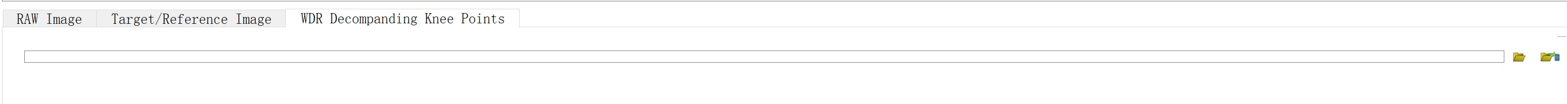

Hi TI experts,
I'm working on CCM tuning in DCC Color correction plugin.
As the snapshot showed, WDR Decompanding Knee Points file is needed. Could you help send me an example of it? Thanks.

The attached image is not able to view so can you re-attach it?
Gaviraju
Hello Zs,
There is an example provided in the plugin guide "Color Correction plugin guide.pdf"
You will need to replace the example PWL kneepoints with the actual parameters of PWL curve of the sensor you are tuning. You should be able to get this information from your sensor vendor.
