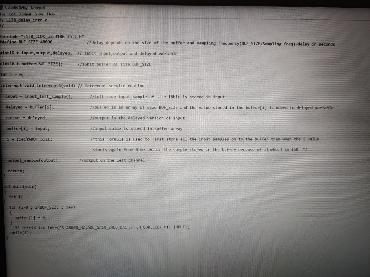

Recently I had purchased few TMS320C6748 Kits, As I started testing the boards I found that in one of the board MIC input is not working, all the other boards are working fine with the MIC and one board is giving the problem with the MIC, Its not working at all,
I have attached the pictures of defected board, kindly help me out from this ASAP.
