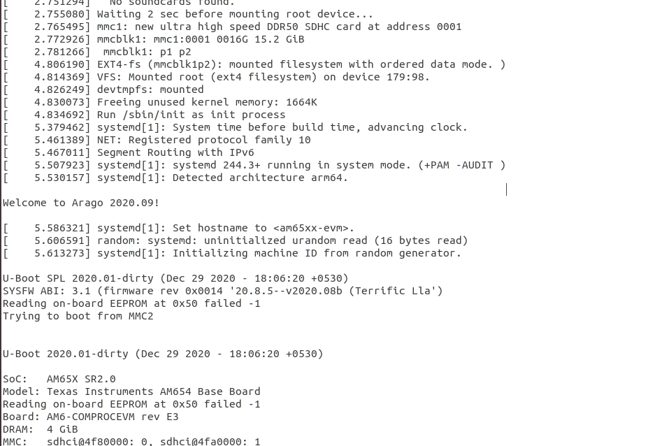

AM6546: Kernel rebooting during mounting rootfs
Part Number: AM6546
    We are using AM6546 custom board with SDK versioned 07_01_00_17.
1. When use R5 : tiboot3.bin, there is no console debug
2. When mounting rootfs, kernel rebooting
Please help me to get solution and find the attached debug log for your reference.

[    2.755080] Waiting 2 sec before mounting root device...
[    2.765495] mmc1: new ultra high speed DDR50 SDHC card at address 0001
[    2.772926] mmcblk1: mmc1:0001 0016G 15.2 GiB
[    2.781266]  mmcblk1: p1 p2
[    4.806190] EXT4-fs (mmcblk1p2): mounted filesystem with ordered data mode. )
[    4.814369] VFS: Mounted root (ext4 filesystem) on device 179:98.
[    4.826249] devtmpfs: mounted
[    4.830073] Freeing unused kernel memory: 1664K
[    4.834692] Run /sbin/init as init process
[    5.379462] systemd[1]: System time before build time, advancing clock.
[    5.461389] NET: Registered protocol family 10
[    5.467011] Segment Routing with IPv6
[    5.507923] systemd[1]: systemd 244.3+ running in system mode. (+PAM -AUDIT )
[    5.530157] systemd[1]: Detected architecture arm64.
Welcome to Arago 2020.09!
[    5.586321] systemd[1]: Set hostname to <am65xx-evm>.
[    5.606591] random: systemd: uninitialized urandom read (16 bytes read)
[    5.613273] systemd[1]: Initializing machine ID from random generator.
U-Boot SPL 2020.01-dirty (Dec 29 2020 - 18:06:20 +0530)
SYSFW ABI: 3.1 (firmware rev 0x0014 '20.8.5--v2020.08b (Terrific Lla')
Reading on-board EEPROM at 0x50 failed -1
Trying to boot from MMC2
U-Boot 2020.01-dirty (Dec 29 2020 - 18:06:20 +0530)
SoC:   AM65X SR2.0
Model: Texas Instruments AM654 Base Board
Board: AM6-COMPROCEVM rev E3
DRAM:  4 GiB
MMC:   sdhci@4f80000: 0, sdhci@4fa0000: 1

  • Hi Keerthy,
                     In custom board, we are using UART1 for console debug, so "prints from A72 SPL i.e tispl.bin" its prints receiving in UART0.
    After this kernel getting continuous reboot.
    For more log details please find previous attachment.
  • Hi Keerthy,
     Thanks for your support. Problem resolved, Its happened due to limited supply current.
