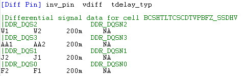

In the IBIS model of AM4378 for DDR3L simulation we are facing below issues
1. IBIS model (selector) of DQSP and DQSN is not same, both are different. Any particular reason for the different model selector for signals  in same differential pair. Can this be changed in the IBIS model by TI?
.      2. Clock pins haven’t been declared as differential pins in IBIS model. Please help us in assigning the same in IBIS model to run simulation
M Amarnath
