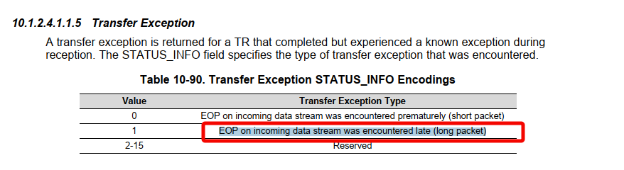

I tried to configure the deserializer to 2.5Gbps 4lane, When testing two 4K cameras (3840 * 1920 raw12),csirx driver can't receive the image,
We find that in the "CsirxDrv_udmaCQEventCb" function,As shown in the figure below:
So we looked up the TRM
What is the reason for this problem?
And when I set the camera to 3780 * 1920 raw12,it can work normally.
Why does the 3840 * 1920 raw12 configuration not work,Are there any restrictions on UDMA in the case of 2.5Gbps 4lane?
