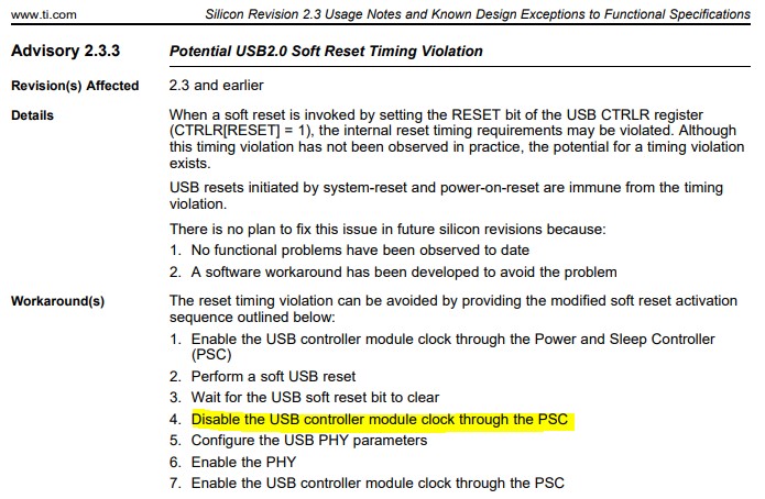

I'm referring the following errata "Advisory 2.3.3"
www.tij.co.jp/.../sprz313h.pdf
I'd like to know more about above yellow sequence.
Which value should be set to which register for it?

The only PSC corresponding to USB 2.0 is PSC1 and LPSC Number 1 as per Table 6-12 in the datasheet. The register for the module would be PSC1 MDTCL for the LPSC number 1 which I believe will be at location 0x01E27A04 [ 0x01E27A00 + 4 * 1]. To disable the module clock, you need to set the last three bit to 0x2 as per technical reference manual.
