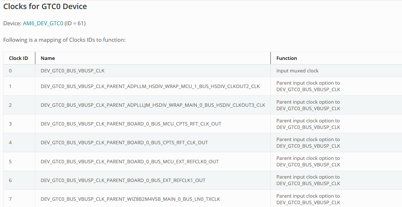

  • Hi Dominic,
    I checked internally and here are a few points
    1. pdk/packages/ti/board/src/am65xx_idk/am65xx_idk_pll.c is not used any more. All clocks are set by: pdk\packages\ti\board\src\evmKeystone3\board_pll.c
    2. The GTC can take the clock from multiple sources. See below
    The image is taken from here
    3. Option 0 – Gives 200 MHz which is default. Option 1 – Gives 250 MHz which is what you need for CPTS and to have backward compatibility with previous changes.
    4. To configure the GTC, use this API call
    status = Sciclient_pmSetModuleClkParent(
                   TISCI_DEV_GTC0,
                   TISCI_DEV_GTC0_BUS_VBUSP_CLK,
                   TISCI_DEV_GTC0_BUS_VBUSP_CLK_PARENT_ADPLLLJM_HSDIV_WRAP_MAIN_0_BUS_HSDIV_CLKOUT3_CLK,
                  SCICLIENT_SERVICE_WAIT_FOREVER);

    Now that you know the module ID and clock ID, the next step is to look at the
    TRM or the Clock tree tool to see if this clock has a multiplexer sitting before
    this. If yes, you need to make a choice of where this clock is going to be sourced from.
    For example,
    The GTC module in AM65xx can take the clock from multiple sources:
    Option 1 – Gives 250 MHz.
    To set the clock to 250 MHz use the below API:
    .. code::
                                        TISCI_DEV_GTC0,
