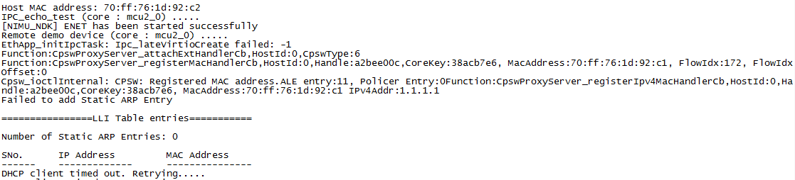

Hi.
    when i use  prebuild boot & image from SDK 07_01_00.
    The EVM board boot ok.
    But EthFw boot log in UART2 like this:
CPSW Ethernet Firmware
CPSW_9G Test on MAIN NAVSS
ETHFW Version : 0.01.01
ETHFW Build Date: Nov 12, 2020
ETHFW Build Time: 01:42:42
ETHFW Commit SHA: b4628e2d
Host MAC address: 70:ff:76:1d:92:c2
IPC_echo_test (core : mcu2_0) .....
[NIMU_NDK] ENET has been started successfully
Remote demo device (core : mcu2_0) .....
EthApp_initIpcTask: Ipc_lateVirtioCreate failed: -1
Function:CpswProxyServer_attachExtHandlerCb,HostId:0,CpswType:6
Function:CpswProxyServer_registerMacHandlerCb,HostId:0,Handle:a2bee00c,CoreKey:38acb7e6, MacAddress:70:ff:76:1d:92:c1, FlowIdx:172, FlowIdxOffset:0
Cpsw_ioctlInternal: CPSW: Registered MAC address.ALE entry:11, Policer Entry:0DHCP client timed out. Retrying.....
    And the switch doesn't working.
    How can i fixed this problem.
    Thanks.

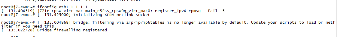

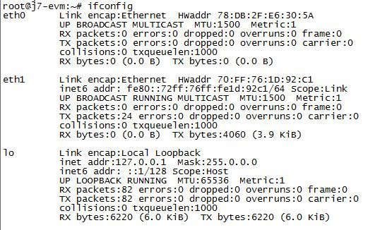

    1. How are you booting ? I am assuming Linux boot on A72.
    2. Can you post the Linux boot logs ?
    Vineet
  • Just boot from SD.
    UART0 full boot log:

    UART2 log like this:
    I don't konw if there is something need to be configured or just another promble.

    What do you see when you type ifconfig in Linux ?
    Vineet
  • Hi.
        when I type ifconfig,  I can see eth0 and eth1.
        like this:
    while i try to configure eth1 with static ip , it just return -5
    and "Failed to add Static ARP Entry"  error appear in UART2
