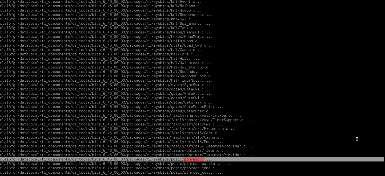

    After adding the above changes we are running the below commands to build the pthread.c source file as a part of RTOS binary.
    cd $INSTALL_DIR/vision_sdk/build
    gmake -s -j
    Sample build log:
    Gaviraju
