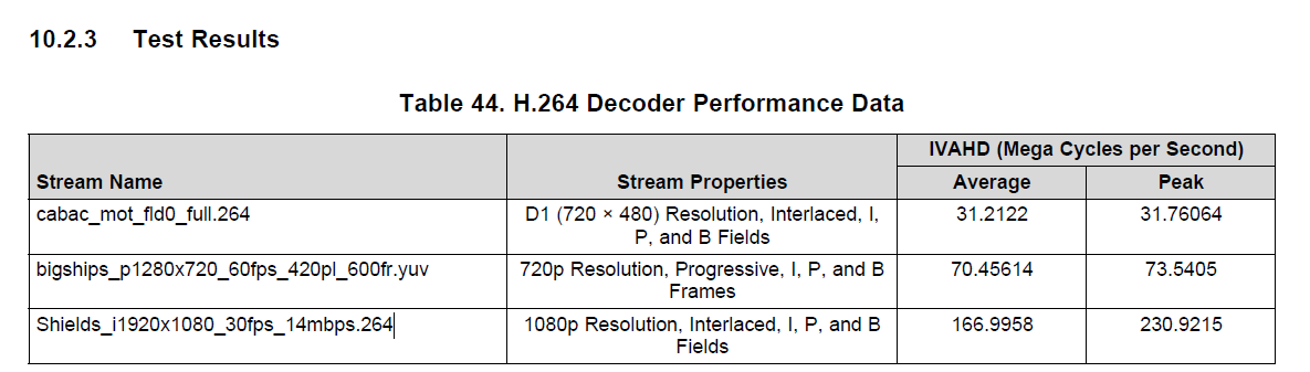

But now for improve DDR bindwidth on IVA, I need swith it to H264. My command:
gst-launch-1.0 -e cameravpf name=camerasrc channel=4 recordtype=event ! video/x-raw,format=NV12,width=1280,height=720,framerate=30/1 ! ducatih264enc profile=100 entropy-coding-mode=1 inter-i
nterval=2 bitrate=4096 ! h264parse ! qtmux  ! filesink location=aaa.mp4
The mp4 file below I got has problem. And the frame seems out of order. Since from video, I wave hand from top to bottom, it will jump back to top when at the middle.
Did I miss something?
