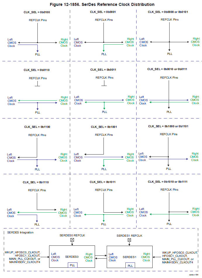

In Figure 12-1856 on TRM, the colored lines in the diagrams indicates the possible REFCLK distribution for the adjacent SerDes.
The colored (green) lines only come from the Right CMOS Clock in the diagrams.
Do the colored (green) lines indicate that the REFCLK coming from the adjacent SerDes can come only from the Right CMOS Clock?
Can the REFCLK coming from the adjacent SerDes come from the Left CMOS Clock?
Can the REFCLK coming from the internal clock sources come from both the Right CMOS Clock and Left CMOS Clock?
If same REFCLK is distributed to both SERDES0 and SERDES1, is it required that the REFCLK comes from the SERDES1 side?

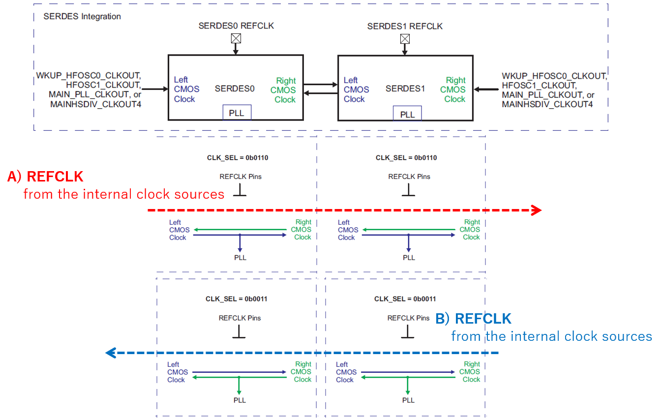

    I would like to know how to distribute REFCLK when using PCIe as a single 2-lane port and Root complex.
    Please give me an answer as soon as possible. Your prompt reply would be appreciated.
    Daisuke
    If same REFCLK coming from the internal clock sources is distributed to both SERDES0 and SERDES1, which of A) and B) in the figure below should be used?
    In that case, which of REFCLK0N/P and REFCLK1N/P should be used as the REFCLK output to a single external device?
    Daisuke

  • Daisuke,
    I understand you like to configure the PCIe as 1px2L RC, and then drive out a REFCLK to the EP via the slot. In this case, please note the following:
    1. In 2-lane mode, the two SERDES MUST chain their refclk. i.e., you can either use SERDES0 or SERDES1 to obtain refclk (either from REFCLK input pins, or from internal PLLs), then the other SERDES MUST obtain its refclk from its neighbor via chaining. We have verified either chaining leftward or rightward would work.
    2. To refclk output signal is directly driving out of SOC DIRECTLY from the mux output that feeds the SERDES. i.e., say you choose MAIN_PLL_OUT to drive a 100MHz refclk to feed SERDES0, this 100MHz clock is simultaneously sent out to the REFCLK out pins, upon converting to differential signals. this way you can implement common clock PCIe architecture.  Note again in this case, the SERDES1 gets its refck from SERDES0.
    If you are using Linux SDK, the standard Linux SD card images will recognize the IDK (vs. GPEVM), and therefore the correct device tree files are loaded that enables 2Lane RC port with REFCLK enabled on the slot.
    If you are using RTOS SDK, you may use "BOARD=am65xx_idk", that will enable macros in source code to use PCIe controller 0 and get SERDES configurations right. The REFCLK output is not enabled by default in RTOS, you may use following reference to find the mux control of the refclk output.
    /* CTRLMMR_SERDES0_REFCLK_SEL Register 0x0010_8020[1:0] = 0x2, MAIN_PLL_CLKOUT
    CTRLMMR_SERDES1_REFCLK_SEL Register 0x0010_8024[1:0] = 0x2, MAIN_PLL_CLKOUT
    CSL_FINSR(*(volatile uint32_t *)(CSL_CTRL_MMR0_CFG0_BASE + CSL_MAIN_CTRL_MMR_CFG0_SERDES0_REFCLK_SEL), 1, 0, 0x2);
    CSL_FINSR(*(volatile uint32_t *)(CSL_CTRL_MMR0_CFG0_BASE + CSL_MAIN_CTRL_MMR_CFG0_SERDES1_REFCLK_SEL), 1, 0, 0x2);
    I think most of your questions should be answered once we clarify that REFCLK is directly driven out of the SOC vs. from SERDES. Please pls reply back if you still have questions.

  • Hi Jian-san,
    Thank you for your reply.
    I was confused by the following description in section 12.2.4.3.1.2 on TRM.
    "The colored lines in the diagrams indicates the possible REFCLK distribution for the adjacent SerDes. For
     the side without an adjacent Serdes, clock output is tie off."
    I understand that the color lines are indicate both black and green lines, and the REFCLK does not distribute if there is no PLL or no adjacent SerDes at the end of the arrow.
    Daisuke
