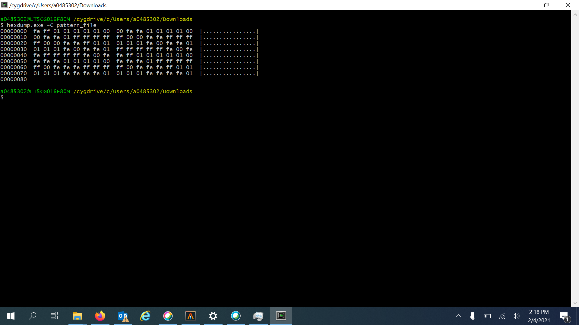

  • Sentinen.Chen said:
    •        Do you know where we can get the related pattern file for MT35XU01G?
    Attaching the pattern file here: https://e2e.ti.com/cfs-file/__key/communityserver-discussions-components-files/791/pattern_5F00_file

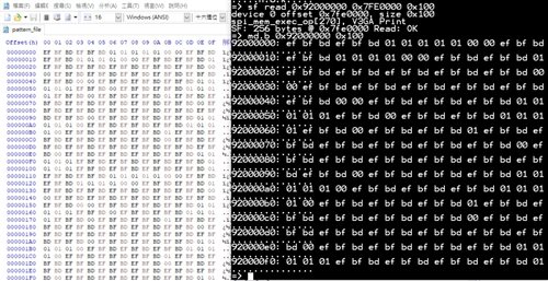

  • Hi Keerthy:
    I try this patch, but the PHY calibration is still failed.
    So I try to dump failed log,
    I find it already failed at the first "cadence_spi_find_rx_low" function when phy calibration step start.
    So I try to dump the rx read data, like below modify
            ret = spi_mem_exec_op(spi, &op);
    -       if (ret)
    +       if (ret) {
    +               printf("%s[%d], V3GA Print\n", __func__, __LINE__);
                    goto out;
    +       printf("%s[%d], V3GA Print 0x%x\n", __func__, __LINE__, read_data);
            if (memcmp(read_data, phy_tuning_pattern,
                       ARRAY_SIZE(phy_tuning_pattern))) {
                    ret = -EAGAIN;
                    goto out;
    follow the log, it seem the read_data all can't map to phy_tuning_pattern, so the calibration still get failed result.
    The pattern should as (this define in drivers/spi/cadence_qspi.c)
       static const u8 phy_tuning_pattern[] = {
       0xFE, 0xFF, 0x01, 0x01, 0x01, 0x01, 0x01, 0x00, 0x00, 0xFE, 0xFE, 0x01, 0x01,
       0x01, 0x01, 0x00, 0x00, 0xFE, 0xFE, 0x01, 0xFF, 0xFF, 0xFF, 0xFF, 0xFF, 0x00,
       0x00, 0xFE, 0xFE, 0xFF, 0xFF, 0xFF, 0xFF, 0x00, 0x00, 0xFE, 0xFE, 0xFF, 0x01,
       0x01, 0x01, 0x01, 0x01, 0xFE, 0x00, 0xFE, 0xFE, 0x01, 0x01, 0x01, 0x01, 0xFE,
       0x00, 0xFE, 0xFE, 0x01, 0xFF, 0xFF, 0xFF, 0xFF, 0xFF, 0xFE, 0x00, 0xFE, 0xFE,
       0xFF, 0xFF, 0xFF, 0xFF, 0xFE, 0x00, 0xFE, 0xFE, 0xFF, 0x01, 0x01, 0x01, 0x01,
       0x01, 0x00, 0xFE, 0xFE, 0xFE, 0x01, 0x01, 0x01, 0x01, 0x00, 0xFE, 0xFE, 0xFE,
       0x01, 0xFF, 0xFF, 0xFF, 0xFF, 0xFF, 0x00, 0xFE, 0xFE, 0xFE, 0xFF, 0xFF, 0xFF,
       0xFF, 0x00, 0xFE, 0xFE, 0xFE, 0xFF, 0x01, 0x01, 0x01, 0x01, 0x01, 0xFE, 0xFE,
       0xFE, 0xFE, 0x01, 0x01, 0x01, 0x01, 0xFE, 0xFE, 0xFE, 0xFE, 0x01,
    but the read data I dump is always 0x81f0xxxx
    cadence_spi_find_rx_low[138], V3GA Print
    cadence_spi_phy_check_pattern[113], V3GA Print 0x81f006c0

    Try verifying if the PHY pattern is actually present on the flash or not. This can be done by going to U-Boot prompt and running:
    sf probe
    sf read 0x92000000 0x7fe0000 0x100
    md.b 0x92000000 0x100
    Keerthy
  • Hi Keerthy:
    It seem the data on OSPI flash is OK.
    Please see below compare picture
    BR
    Sentinen Chen
  • Hi Sentinen,
    The pattern file shared is 128 bytes. Here is the snapshot.
    Also OSPI boot is broken on 7.1 & internal teams are working on fixing it.
    DMA is not functional on SPL and hence you will be seeing mbox time out.
    So OSPI Boot needs to wait for fix on 7.1.
