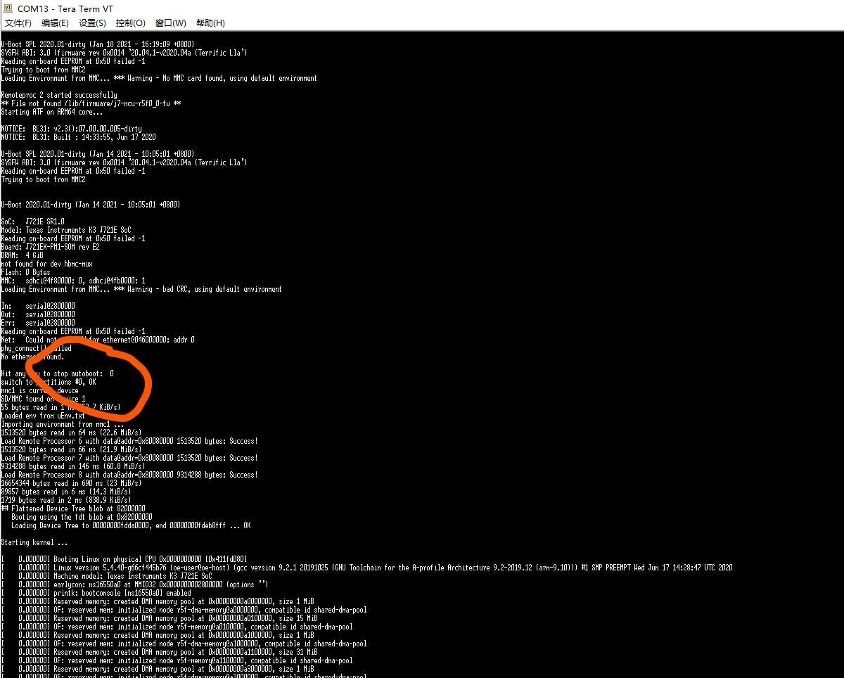

hi :
We own the TDA development board, very few peripheral devices, electricity after the stop in the boot screen, found that the TF card VQMMC power 3.3 V, according to e2e.ti.com/.../943299, modified code, no other changes, still can't start now, with the two problems
1) Under Boot,  cannot press any key to enter the Boot console, directly jump to the kernel to start
2) The kernel is stuck in 5 seconds or so. The log is as follows:
U-Boot SPL 2020.01-gf9b0d030d3 (Jun 17 2020 - 15:08:08 +0000)
SYSFW ABI: 3.0 (firmware rev 0x0014 '20.04.1-v2020.04a (Terrific Lla')
Reading on-board EEPROM at 0x50 failed -1
Trying to boot from MMC2
Loading Environment from MMC... *** Warning - No MMC card found, using default environment
Remoteproc 2 started successfully
** File not found /lib/firmware/j7-mcu-r5f0_0-fw **
Starting ATF on ARM64 core...
NOTICE: BL31: v2.3():07.01.00.004-1-g52c334fc3-dirty
NOTICE: BL31: Built : 18:17:14, Nov 19 2020
U-Boot SPL 2020.01-dirty (Jan 05 2021 - 16:55:50 +0800)
U-Boot 2020.01-dirty (Jan 05 2021 - 16:55:50 +0800)
SoC: J721E SR1.0
Model: Texas Instruments K3 J721E SoC
Board: J721EX-PM1-SOM rev E2
DRAM: 4 GiB
not found for dev hbmc-mux
Flash: 0 Bytes
MMC: sdhci@4f80000: 0, sdhci@4fb0000: 1
Loading Environment from MMC... *** Warning - bad CRC, using default environment
In: serial@2800000
Out: serial@2800000
Err: serial@2800000
Net: Could not get PHY for ethernet@46000000: addr 0
phy_connect() failed
No ethernet found.
Hit any key to stop autoboot: 0
switch to partitions #0, OK
mmc1 is current device
SD/MMC found on device 1
55 bytes read in 2 ms (26.4 KiB/s)
Loaded env from uEnv.txt
Importing environment from mmc1 ...
4839748 bytes read in 205 ms (22.5 MiB/s)
Invalid op: Trying to load/start on already running core 6
Load Remote Processor 2 with data@addr=0x82000000 4839748 bytes: Failed!
1513520 bytes read in 66 ms (21.9 MiB/s)
Load Remote Processor 6 with data@addr=0x82000000 1513520 bytes: Success!
1513520 bytes read in 79 ms (18.3 MiB/s)
Load Remote Processor 7 with data@addr=0x82000000 1513520 bytes: Success!
9314288 bytes read in 137 ms (64.8 MiB/s)
Load Remote Processor 8 with data@addr=0x82000000 9314288 bytes: Success!
16654344 bytes read in 692 ms (23 MiB/s)
89857 bytes read in 8 ms (10.7 MiB/s)
1719 bytes read in 3 ms (559.6 KiB/s)
## Flattened Device Tree blob at 88000000
Booting using the fdt blob at 0x88000000
Loading Device Tree to 000000008fee7000, end 000000008fffffff ... OK
Starting kernel ...

    Let us first focus on:
    What is the terminal application that you are using? Just make sure of settings like below:
    | A - Serial Device : /dev/ttyUSB0 |
    | B - Lockfile Location : /var/lock |
    | C - Callin Program : |
    | D - Callout Program : |
    | E - Bps/Par/Bits : 115200 8N1 |
    | F - Hardware Flow Control : No |
    | G - Software Flow Control : No |
    Keerthy
  • The serial port tool I used was TERA TERM, and we used UART0 without UART to USB Bridge-FT4232 chip. The specific circuit schematic diagram is as follows
    Pressing any key marked in red in TERA TERM will not stop at the console, but will start directly into the kernel.
    You could rename the boot folder under the rootfs(ext) partition & check if that gets you to u-boot prompt
    without directly jumping to kernel & then check if your UART commands work.
    Keerthy
  • hi
        According to your suggestions, I have solved the problem of entering the console under boot, which is the wiring harness problem.However, the problem of program jammed in the Linux kernel still exists. I don't know whether our system board has been clipped relative to the official board, resulting in incompatible software and hardware. Should we cut the device tree accordingly
    No ethernet found.
    55 bytes read in 1 ms (53.7 KiB/s)
    1513520 bytes read in 65 ms (22.2 MiB/s)
    Load Remote Processor 6 with data@addr=0x80080000 1513520 bytes: Success!
    U-Boot SPL 2020.01-dirty (Jan 20 2021 - 15:24:41 +0800)
    NOTICE: BL31: v2.3():07.00.00.005-dirty
    NOTICE: BL31: Built : 14:33:55, Jun 17 2020
    U-Boot SPL 2020.01-dirty (Jan 14 2021 - 10:05:01 +0800)
    U-Boot 2020.01-dirty (Jan 14 2021 - 10:05:01 +0800)
    SoC: J721E SR1.0
    DRAM: 4 GiB
    Flash: 0 Bytes
    Loading Environment from MMC... OK
    In: serial@2800000
    Out: serial@2800000
    Err: serial@2800000
    Net: Could not get PHY for ethernet@046000000: addr 0
    No ethernet found.
    1513520 bytes read in 64 ms (22.6 MiB/s)
    SoC: J721E SR1.0
    DRAM: 4 GiB
    Flash: 0 Bytes
    In: serial@2800000
    Out: serial@2800000
    Err: serial@2800000
    No ethernet found.
    SoC: J721E SR1.0
    DRAM: 4 GiB
    Flash: 0 Bytes
    In: serial@2800000
    Out: serial@2800000
    Err: serial@2800000
    No ethernet found.
    Load Remote Processor 7 with data@addr=0x80080000 1513520 bytes: Success!
    9314288 bytes read in 145 ms (61.3 MiB/s)
    Load Remote Processor 8 with data@addr=0x80080000 9314288 bytes: Success!
    16654344 bytes read in 689 ms (23.1 MiB/s)
    89857 bytes read in 7 ms (12.2 MiB/s)
    1719 bytes read in 2 ms (838.9 KiB/s)
    ## Flattened Device Tree blob at 82000000
    Booting using the fdt blob at 0x82000000
    Loading Device Tree to 00000000fdda0000, end 00000000fdeb8fff ... OK
    Starting kernel ...

  • hi:
    I found that our hardware OSCXI and OSCXO crystal oscillator had the official development board of 22.2592m replaced with 20M, I don't know whether there is any influenc
     e
    That could be one reason. Before we get there can you tell me what are the modules that are not present on your custom board?
    You Can knock of the device tree nodes by setting their status="disabled";
    Try booting and experiment by starting with lesser DT nodes.
    Keerthy
    our own system board only retains the LPDDR4 module, EMMC module, TF Card, QSPI Norflash of the official development board, as well as our own newly added UB962 and 941 input and output, and that's all
     I don't know which device tree needs to be modified. Does the kernel need to be compiled to modify the device tree? What specific files need to be modified and what compilation commands need to be made
    wang
  • Hi Wang,
    Are you able to proceed further? You still have 4GB of DDR like TI EVM? If that is reduced then we will
    have issues while booting due to lack of memory & we need to disable some nodes. Please confirm the
    DDR size.
    Also i am still not sure why you are unable to halt at u-boot prompt.
    Keerthy
  • HI
    The model LPDDR4 MT53D1024M32D4DT-046 D9WQG cannot be stopped under U-BOOT. The problem of serial port TX and RX connection line has been solved. Now I can stop entering the console under UBOOT, but the kernel still cannot get up
    Could you share the latest logs? Is it crashing well before 5 seconds? The initial log pasted was hanging here:
    [ 5.290408] Waiting for root device PARTUUID=2903bc21-02...
    This is suggesting issue with MMC detection.
    Can you attach the latest kernel hang logs here as text document?
    Keerthy
