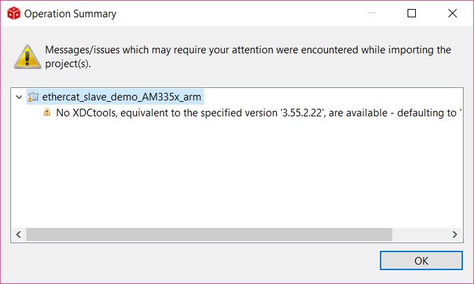

After following the steps you described, only one warning message was left:
Still, I could import the project. However, trying to build it through the following errors:

    The XDC tools version mismatch warning indicates that the XDC tools version specified in the CCS project and that installed in CCS products does not match exactly. This can be resolved by following the system requirements specified for a specific version of industrial package (eg: https://software-dl.ti.com/processor-industrial-sw/esd/docs/indsw/EtherCAT_Slave/01_00_08/PRU_ICSS_EtherCAT.html#system-requirements

    !WARNING: No XDCtools, equivalent to the specified version '3.55.2.22', are available - defaulting to '3.61.2.27_core'.

    Sorry for the long answer, I suppose a few files are missing. Where would I find these files?
