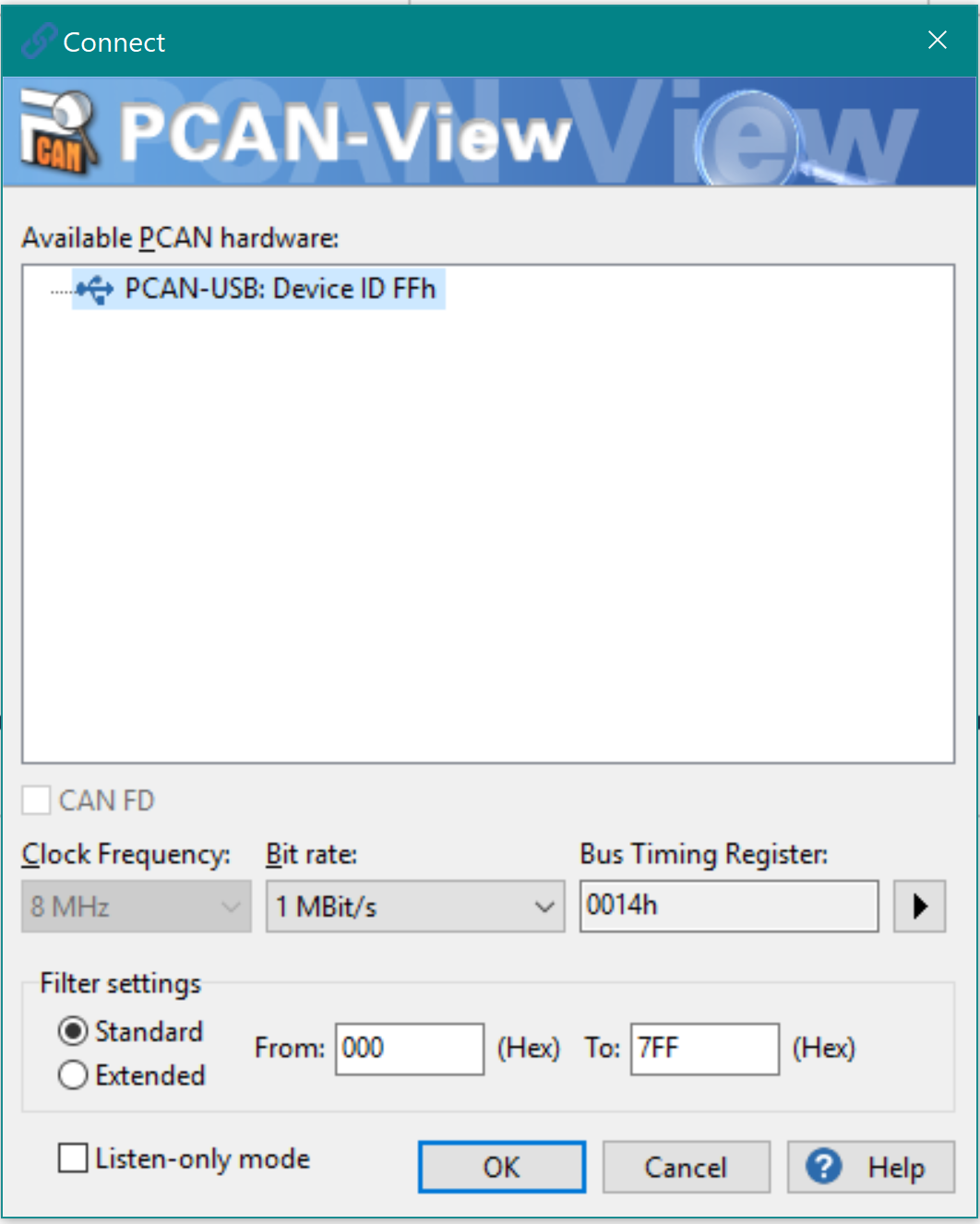

    Thank you for the help. Now I have can0 & can6 both interface showing up in Linux.
    On sending and receiving the data, I still don't see the full data on CAN emulator. This is the command I am sending from J7 -
    ip link set can0 type can bitrate 1000000
    ip link set can0 up
    cansend can0 123#DEADBEEF
    On Emulator side I still don't see the full data -
    This is my initial setup for CAN emulator setup
    Any debugging tips would be helpful here.
    Thank you again for your help.
    Satish

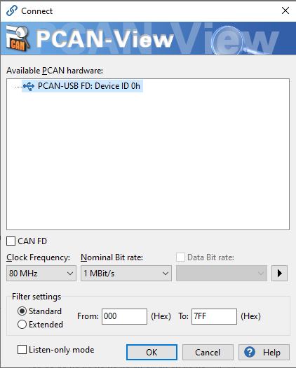

  • Hi Satish,
    One thing I see is that you are configuring Clock Frequency of PCAN as 8MHz. Module clock for MCAN on TDA4 is 80MHz.
    Below are my setting:
    The missing data issue was there with loopback too, I think we should focus on that. These issues seem to be same.

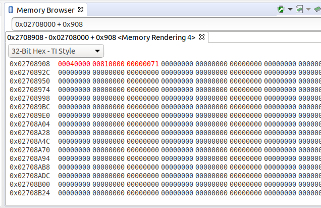

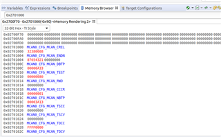

    Connect CCS, do NOT run GEL files, just attach to MCU2_1 (or any other core)
    Open Memory browser and check the register: MCAN0_CFG_MCAN_TXBC (0x027010C0) register and note the "value" of 15:2.
    -3-
    In the memory browser look at MCAN0 Message RAM: 0x02708000 + "value" << 2 (Value left shifted by 2)
    The above should be 0s.
    Now send the message using:
    cansend can0 113##2AAAAAAAA
    Again look at the same memory address, does it have the full message?
    Example of my setup:
    MCAN0_CFG_MCAN_TXBC = 0x01000908
    => value = 0x242
    => value << 2 = 0x908
    Address to be monitored before and after sending message:
    0x02708000 + 0x908 --> This is the first Tx buffer. Most likely the driver will use the 1st free buffer hence this should have the message.
    Karan

    I was reviewing the thread and I see a problem here with the CAN TX frame which is getting generated.
    From the memory browser snippet which you shared post the execution of "cansend can0 113##2AAAAAAAA"
    0x0270_8908 :: 0004_0000
    0x0270_890C :: 0081_0000
    0x0270_8910 :: 0000_0071
    Where as with the same cansend command I have:
    0x0270_8908 :: 044C_0000
    0x0270_890C :: 00A4_0000
    0x0270_8910 :: AAAA_AAAA
    So there is a problem with this buffer which will be transmitted. I tried to create the buffer (by writing directly to the memory from CCS) which you have and I see similar results as you.
    Can you try one experiment: (I am attaching a small video to help you with this)
    Using the same process which you used before, connect CCS and modify the addresses 0x0270_8908 to 0x0270_8910 as mentioned by me: (see above of see the snapshot I had sent earlier). This will create a valid message to be transmitted on the bus and then once you have that, trigger the message by writing to 0x1 to MCAN0_CFG_MCAN_TXBAR (0x0270_10D4).
    Video: /cfs-file/__key/communityserver-discussions-components-files/791/can_5F00_linux_5F00_transmission.zip
    Now, if this goes through then we know for sure that there is an issue with creating of the Tx buffer and no issue with HW.
    Karan

    1. What settings do you have on the PCAN node side? All the CAN nodes on the bus should be configured the same, i.e. Classic CAN with 1Mbps bit rate here.
    I was able to verify on the EVM with these commands. PCAN settings as below:
    /resized-image/__size/320x240/__key/communityserver-discussions-components-files/791/pastedimage1619279875830v1.png

    I am using the following Setting on PCAN View.
    Regarding 8MHz (My setting) vs 80 MHz (Your setting) - In my case, It doesn't allow me to select 80 MHz from the PCAN tool. The dropdown box is locked/disabled.
    I called this PEAK tool provider (i.e. PHytools) , and spoke about selecting 80 MHz from the Dropdown box of "Clock Frequency". According to them, It is non-selectable. The NXP CAN transceiver contains in this tool uses 8 MHz and that's why it is selecting 8MHz. According to the Changing, the Clock frequency won't change the result and I should focus on the "Bit Rate". For Bitrate we have identical settings i.e. 1MBit for both of us.

    I see the following value changed on CCS memory browser (Red text).
    My device tree settings look like this -

  • Hi Satish,
    I guess I missed asking, does that CCS snapshot make sense to you?
    The PSR register will help understand if there were any protocol errors, can you check that?
    Karan
  • Hi Karan,
    Are you referring to this register?
    MCAN0_CFG_MCAN_PSR - 0x02701044
    - Satish
  • Hi Satish,
    Yes this is the correct register, you can read that and see if there are any protocol errors from the CAN controller. Look at the LEC and DLEC fields.
    Karan
