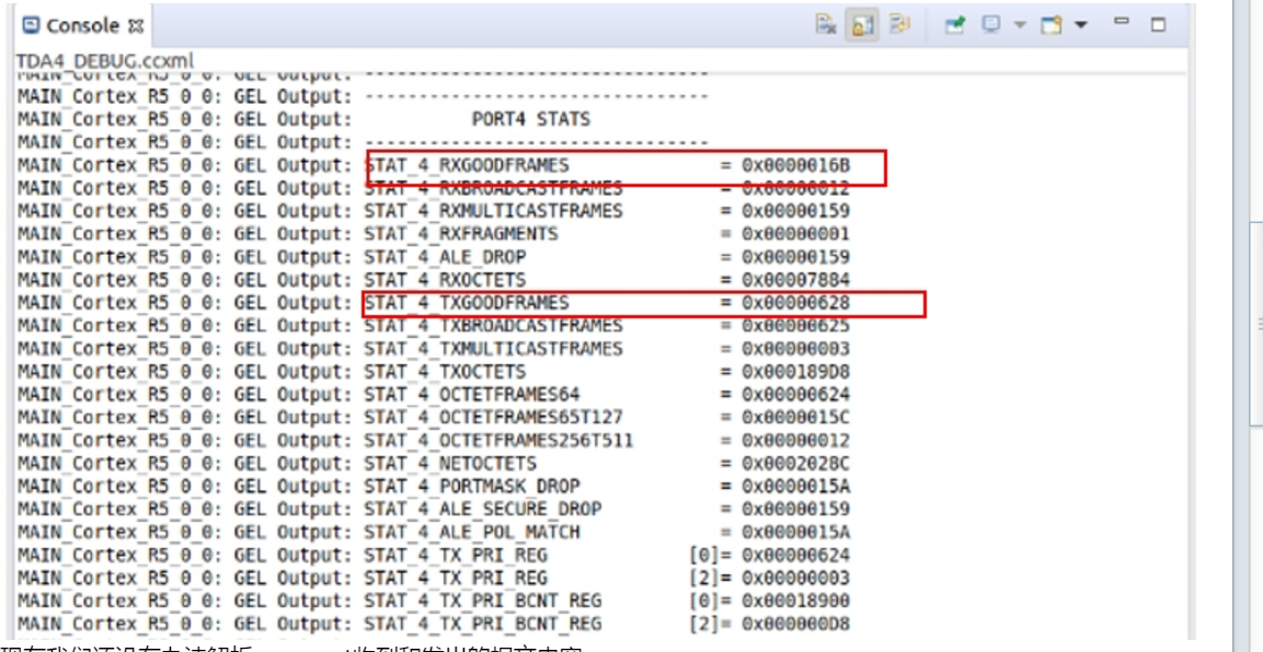

    At present, we can configure PHY to master and slave modes by modifying the PHY control register
    After setting vehicle Ethernet adapter to master and slave respectively, configuring PHY to slave and master working modes; both cases can be linked up and pinged to the PC successfully.
    However, after the two tda4 boards are directly connected through the vehicle Ethernet cable and configured in slave and master modes respectively, the printing status is linkup but ping failed . In addition, when we print out the receiving and sending data of the MAC port and do not Ping another tda4 board, we can also see that there is data sent from the MAC port and the package frame from the opposite end can be received from the slave.

    yes, and they provided some helpful infomations as below:
    >Whether the current case can be considered that PHY has successfully worked in master and slave modes.
    ----If it has been linked up, it should work normally. In addition, after switching master / slave, you need to do soft reset.
    > Whether PHY needs other configuration to realize the direct connection of two tda4 boards through vehicle Ethernet network cable.
    ----There should be no need for other configurations. Theoretically, it should be no different from connecting Ethernet adapter
