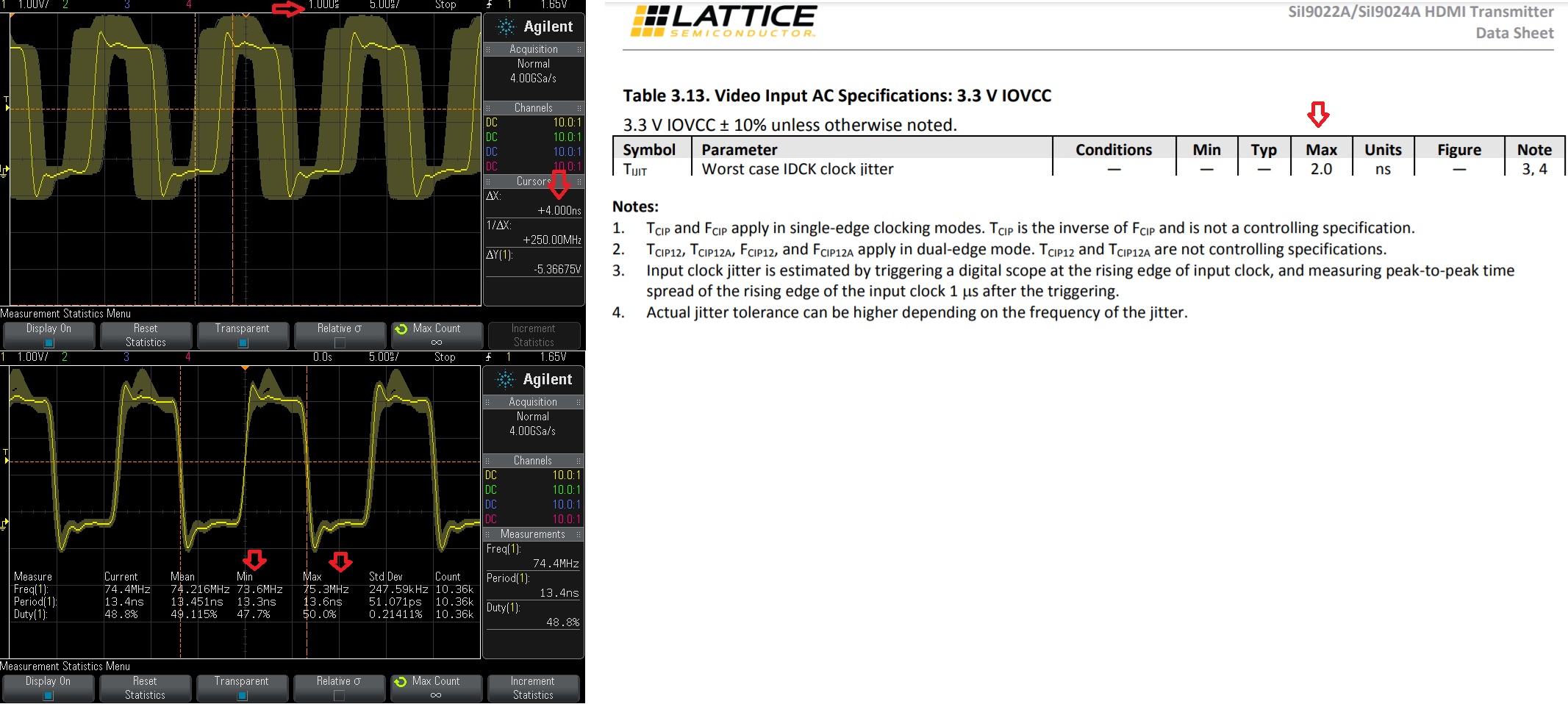

AM4376 Sitara, which we are feeding an HDMI encoder with the display data like the EVM.
SiI9022A/SiI9024A HDMI Transmitter.
At a pixel clock rate of 74.25Mhz  for (1080p 30hz/ 720p)
Design needs to pass HDMI CTS.
Pixel clock duty is well within spec. solid. 48~50% (40-60% allowed). (TEST ID7-7)
The SIL9022A calls for <2ns of jitter, defined in the DS by:
(Input clock jitter is estimated by triggering a digital scope at the rising edge of input clock, and measuring peak-to-peak time spread of the rising edge of the input clock 1 s after the triggering).
Measured 4nS. Which is also beyond what is allowed in the CTS spec (TEST ID 7-9) 3.367nS.
Frequency deviation is over 2x what is allowed (TEST ID7-25).
The core of this design is several years old, no stability issues on DDR3 memory etc, (temp range -40c to 75c).
Do you have any suggestions on improving the pixel clk jitter & frequency tolerance? The AM4376 is generating this clock.
Did the EVM pass CTS?

    "(Input clock jitter is estimated by triggering a digital scope at the rising edge of input clock, and measuring peak-to-peak time spread of the rising edge of the input clock 1 ?s after the triggering)"
    If possible can you also pose a picture of the scope capture showing the jitter edge so I can see if there is a characteristic pattern or not.
    I assume your clock to clock jitter measurements are within spec, just the long term jitter that is out of spec?

  • The HDMI section is on a sub board, this is the signal going to the encoder, so it's purely the AM4376.
    Linux version 4.9.119 (gcc version 7.4.0 (Ubuntu/Linaro 7.4.0-1 ubuntu1~18.04.1)) #299 PREEMPT
    The period was 1uS, per the SIL datasheet 2nS max, I'm at 4nS, see below.
    Linux handles the DPLL settings; beyond the jitter issue, frequency deviation is also out of spec.
    I'll scope the power rails next.
    Barrie

    The frequency variation is really just the instantaneous clock to clock jitter, so that measurement is a red herring. The true average frequency is highlighted by the first capture that also shows the long term jitter. You should use a frequency counter to verify the actual frequency.
    My gut feeling is that the PLL is not getting configured in the optimal range but unfortunately I am not familiar with the PLL.

  • Hi Barrie,
    Are you able to provide any details on how you're setting the PLL? Predivider, m, n etc.
    Andrei
  • Hi Andrei.
    Linux has calculated & is using the following:
    clock: dpll_disp_ck: m = 297: n = 48: new_rate = 148500000
    Can you offer guidance, on what would be better values to use & why?
    Barrie

  • Hi Barrie,
    This combination of reference clock frequency, m/n values, and output frequency is not optimum for accumulated jitter.  The PLL update rate is determined by the pre-divided reference clock frequency going into the PLL.  In your case the 24MHz reference clock (CLKINP) is divided by 48 to create a 500kHz reference clock (REFCLK), which means the PLL is only being updated every 2us.  This slow update rate allows a lot of accumulated error between updates.
    This could be improved significantly by reducing the pre-divider from 48 to 16 and the multiplier from 297 to 99.  This would increase the PLL update from 2us to 0.67us.
    Please let me know if changing these values helps.
    Andrei
  • Hi Andrei, thanks for the input.
    1. Tested n= 16,m= 495
      1. no measurable improvement @ pixel clk 742500000
    2. Tested n=4, m= 99, M2 8. @ pixel clk 742500000
      1. This made the jitter worse ~5.2nS (on the same board) explain that?
    3. I looked at the EVM, stock software pixel clk 33Mhz,
      1. ~3.8nS of jitter. Which is only slightly better than what I’m measuring on custom h/w @ 2x the frequency.
    I’m to be convened this hardware is capable of achieving significant improvement in jitter.
    Did the EVM pass HDMI CTS testing?
    Do you have any other suggestions?
    Barrie

    If increasing the reference frequency to the PFD increases jitter, it may mean that the source of noise is coming from your input reference clock. How are you feeding the input ref. clk?
    Does the pixel clock have to be 74.25 Mhz? The DSS PLL is not a low jitter PLL, if you are able to use something divisible by 192Mhz you can use the Peripheral PLL which IS low jitter.

  • 24Mhz, xtal. Pixel clk must be 74.25 per CEA-861, referenced by the HDMI std for 720p/1080p.
    The EVM is no better. TI code. TI hw.

  • Barrie,
    With 24Mhz input, the most optimal config will be:
    M=99
    N=3
    M2=8
    That will get you 74.25MHz with a 6MHz refclk.  With that particular PLL that is the best you can do.
    Also make sure you have spread spectrum disabled. (Table 6-326. PRCM_CM_CLKMODE_DPL_DISP Register Field Descriptions Bit 12, DPLL_SSC_EN)
