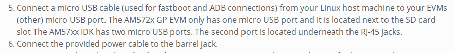

I use uart3 to connect to pc. I can recognize the serial device.
skyliqf@skyliqf-System-Product-Name:~$ ls /dev/ttyUSB*
/dev/ttyUSB0
Enter  $ sudo minicom  in the terminal to connect to the board.
Why does it prompt "Board could not be detected. Please connect the board to the PC" when running setup.sh?
  • After performing steps 5 and 6, the micro USB device cannot be checked on the pc.
    Now running setup.sh can't recognize the micro USB device, is there any other way for ti to flash Android image on emmc ?
