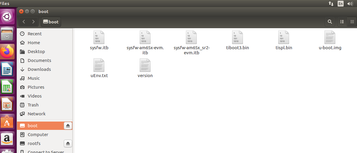

  • snapshot of the boot partition:
  • Tony,
    I hope you have copied the sysfw-am65x_sr2-evm.itb as sysfw.itb?
    Are you sure that the evm at hand is indeed PG2.0?
    In case if you have PG1.0 then you will need an additional fix on SDK 7.1 to boot it:
    Keerthy

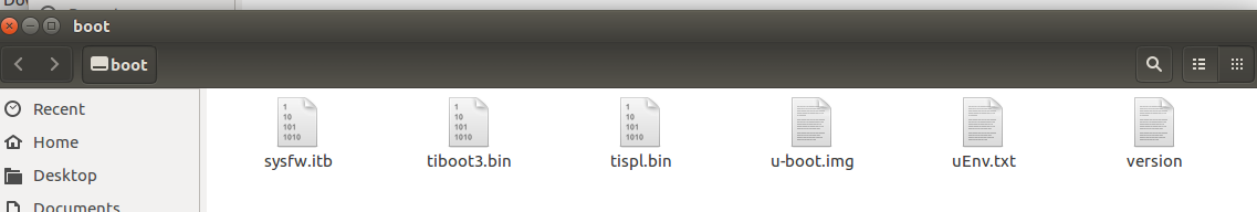

    Do you mean I need to cp  sysfw-am65x_sr2-evm.itb sysfw.itb
  • Tony,
    Tony Tang said:
    That is I am doubting, do you know which register tells the device revision? I can boot the board with PSDK6.3 to read register.
    In u-boot that is being detected by fdt check. Please find the boot images that boot for me on PG2.0.
    boot-images.tar
    Tony: "Do you mean I need to cp  sysfw-am65x_sr2-evm.itb sysfw.itb"
    Yes. The expected name is sysfw.itb.
    Keerthy
  • Keerthy,
    I deleted the files in boot partition, and copied your attached files into SD card as below, still can not boot.
  • Tony,
    Those were the exact binaries from 7.1 SDK that work on my PG2.0 board.
    Could you please try the 7.1 SDK PG1.0 images:
    7.1-pg1.10.tar
    Keerthy
  • Keerthy,
    These files can boot on both old and new board. so the new board actually is PG1.0?
  • Tony,
    Wow! Yes looks like that! Paste the logs & resolve this issue.
    Keerthy
