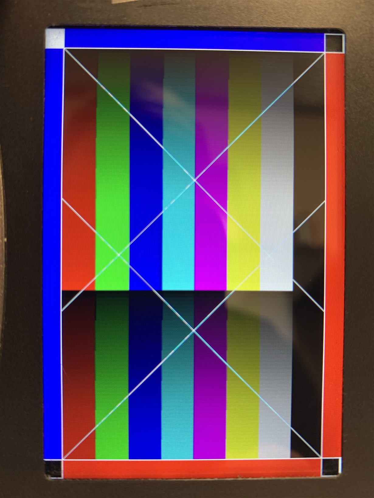

  • Because it was impossible to take photos at that time, we chose to use similar pictures on the Internet,and I chack it 。the filesysterm is the lastest 2019
    I just wanted to confirm that you are using the default images that come from PSDK 6.03 (ti-sdk-rootfs-image-am335x-evm.tar.xz). If yes, please share more details about your display configuration. Is it a LCD or HDMI and have you made any changes to the SW configuration? Also, how many data lines are you using for the display connection?
    Krunal
  • Yes.it's come from PSDK 6.03.  16bit LCD display

    am335xsk.dts
    Add in lcdc: lcdc@4830e000:
     blue-and-red-wiring = "crossed";
  • There is no change in the hardware of LCD
    Thank you for sharing the additional information. Since you are operating in 16bit mode, please review the following document: http://software-dl.ti.com/processor-sdk-linux/esd/docs/latest/linux/Foundational_Components/Graphics/AM3_Beagle_Bone_Black_Configuration.html.
    • /etc/powervr.ini: add DefaultPixelFormat=RGB565
    • /etc/weston.ini: add gbm-format=rgb565 at section [core]
    • /etc/profile.d/qt_env.sh: add export QT_QPA_EGLFS_INTEGRATION=none
    Also, since the blue-red wiring is swapped, please update the following section based on your HW connection. On the BBB, we have a 16bit interface and we set the blue/red wiring to straight. Ref Link: https://git.ti.com/cgit/ti-linux-kernel/ti-linux-kernel/tree/arch/arm/boot/dts/am335x-boneblack-common.dtsi?h=ti-linux-4.19.y#n73
    Krunal
  • There is no /etc/powervr.ini file. So I create the powervr.ini file.
    about the  blue-red wiring ,I let the screen display pictures, my settings can display normal colors
    I made all the changes mentioned,But it still shows "please wait".
    After rebooting the board, could you please share the output of modetest and kmstest.
    Krunal
  • A picture similar to the attached figure is displayed on the screen

    The display is getting recognized and is working as expected. Are you able to run kmscube?
    Krunal
  • Hi. it is:
    root@am335x-evm:~# kmscube ### Display [0]: CRTC = 29, Connector = 31, format = 0x34325258 Mode chosen [800x480] : Clock => 33200, Vertical refresh => 60, Type => 72 Horizontal => 800, 840, 968, 1056, 0 Vertical => 480, 491, 493, 525, 0 ### Primary display => ConnectorId = 31, Resolution = 800x480 PVR:(Error): OpenServices: PVRDRMOpenRender failed [0, ] PVR:(Error): PVRSRVConnect: Unable to open connection. [0, ] PVR:(Error): Couldn't connect to services [0, ] PVR:(Error): PVRDRIEGLGlobalDataInit: PVR Services initialisation failed [0, ] PVR:(Error): PVRDRICreateScreenImpl: Couldn't create EGL global data [0, ] MESA-LOADER: failed to open kms_swrast (search paths /usr/lib/dri) failed to load driver: kms_swrast MESA-LOADER: failed to open swrast (search paths /usr/lib/dri) failed to load swrast driver Segmentation fault (core dumped)
    I am wondering if you could please share boot logs and share the output of modinfo /lib/modules/<kernel>/extra/pvrsrvkm.ko.
    Krunal

    Okay, the GPU and the display is now working as expected. With regards to Weston, it seems like a format mismatch based on the log "format 0x36314752 not supported by output LVDS-1". I apologize for sharing incorrect information earlier but it seems like your display only supports "BG16 RG24 XR24". Please remove the below items and try again
    Krunal

  • Thank you ,the display issues is OK.
    I were just missing the GPU node in the DT file.
