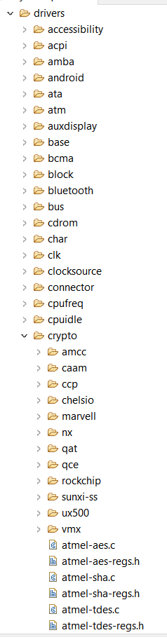

    I've downloaded Linux AM335X SDK Source code available on : software-dl.ti.com/.../Release_Specific_PLSDK_Release_Notes.html
    on git://git.ti.com/processor-sdk/processor-sdk-linux.git :  "branch processor-sdk-linux-04.03.00"
    I've found the Crypto driver in folder : /driver/crypto
    I need the source code of crypto driver for AM335X but I've several folders : which one is for AM335X?
  • Hi Alexis,
    Thanks for reaching out to us.
    AM335x crypto driver in folder:/drivers/crypto/omap-xxxx.c. For example, omap-sham.c, omap-aes.c...
    Plus /drivers/char/hw_random/omap-rng.c
    -Hong

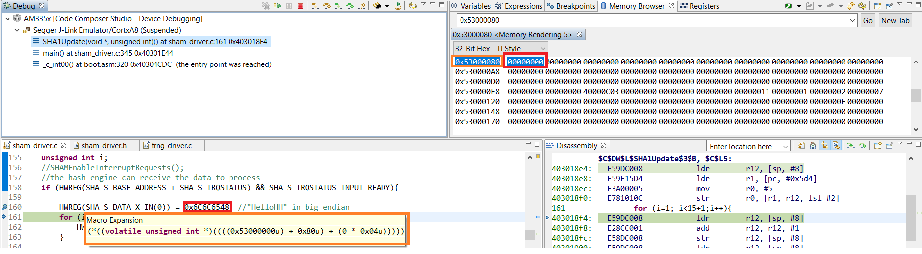

  • Thanks Hong for your Reply,
    Now I'm trying to implement SHAM driver (In a Bare Metal version : polling mode) following the AM335x Cryopto TRM.
    But when I'm trying to fill the DATA_IN buffer in memory : memory still with 0x00000000 value as show in this pict :
    I think it could be an initialisation problem but I can't found the issue.
    So I can't obtain a SHA1 digest :/
    Here the source code :
    SHAMDriverTI.zip
    Could you quickly see the code and show me where should be the issue ? ;)
    Have a good day !
    Thanks for your help !
    Alexis

  • Hi Hong,
    Thanks again for your help ! :)
    For MD5 for example :
    When I writte in DATA_I register it seem not to work (still at 0x000000000) value.
    •  I can see INPUT READY flag before filling data
    • Then at each loop : I can see SHA_S_LENGTH register decreasing from 64 to 0.
    • At the end of my loop : I can find and read a digest in IDIGEST register.
    • Output Flag is Ready
    • Then I read the memory
    I've bring modification in source code there were some issue in the old one : MD5drivers.zip
    When I'm read it :
    For example for (0x00000000)*16 data filling.
    I've got this hash:  ( HashMD5:91773174b767ab1fd08ea56eac1d1f03 ).
    IDIGEST_A Register: 0x031F1DAC
    IDIGEST_B_Register : 0x6EA58ED0
    IDIGEST_C_Register : 0x1FAB67B7
    IDIGEST_D_Register : 0x74317791
    I can't understand where is my issue ;)
    Do you have an idea about it?
    PS : That is why I'm trying to compare with omap-sham.c in Linux Kernel but I've some difficulties to understand the code.
    Best regards.
    Alexis.

  • Hi Alexis,
    I captured two log files, and uploaded them in attachment for your reference:
    - am3_hash_md5_1_before.txt: SHA/MD5 registers are configured, just before filling SHA/MD5 input buffers
    - am3_hash_md5_1_after.tx: right after filling SHA/MD5 input buffers
    Note that in my testing
    - The same testing input vector as yours, i.e., 16 "0x00000000" @0x004016D8
    - SHA/MD5 register @0x53000000(Physical Addr) is mapped to 0xAFD00000(Virtual Addr)
    - SHA_S_DATA_i_IN/SHA_P_DATA_i_IN registers are not visible from JTAG debugger after filling in with input stream as shown in my testing
    Hope the attached two log files are helpful for debugging your bare-metal crypto code.
    -Hong

  • Hi Alexis,
    I took a closer look at your screen-shot from your test run, and noticed that the following change is needed:
    CLOSE_HASH bit or SHA_S_MODE[4] needs to be set to "1" to close the hash calculation in hash_final() call.
    -Hong
  • Thanks you very much for your help Hong : Sorry for delayed reponse. I tried to find by myself before posting here again.
    What code are you using?
    I take into account your changement now it works halfways, I had the same memory as you except the CLOSE_HASH ;)
    It only work when the REGISTER_DATA_LENGHT is a multiple of 4 and less than 54.
    I notice I have to take into account part (3.3.6.1.3 Closing a Hash ) of TRM.
    For example this kind of thing work well :
    Data Written : 0x01010101 (SHA_DATA_0_IN)
    SHA_S_LENGHT : 4
    HashMD5: 3B5B9852567EF7618AAC7F5F2D74EF74
    In attachement my test : with different char* value (And a comparaison with True Hash) :
    Msg : Hell size : 4
    Data to write in memory : 0x6C6C6548 ((SHA_S_DATA_0_IN))
