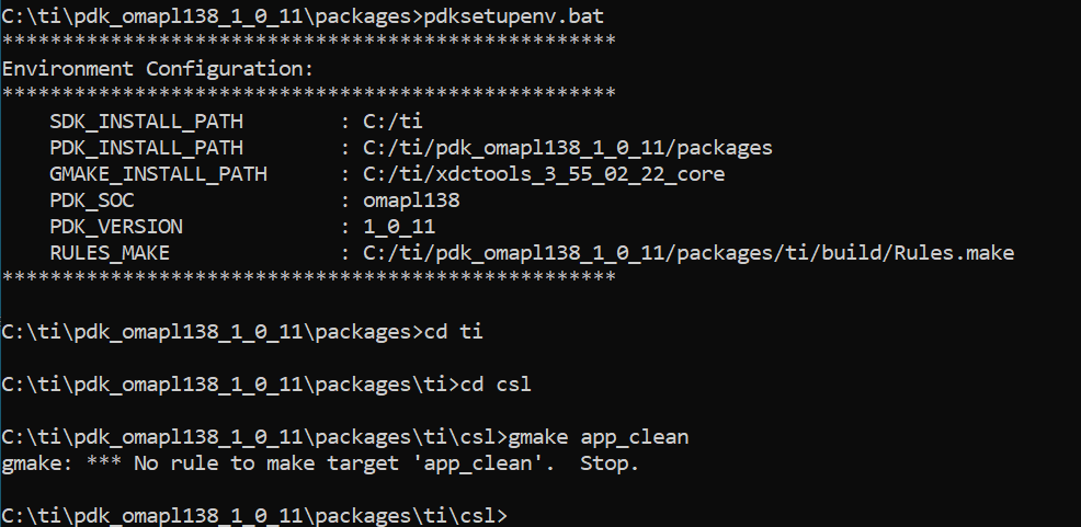

  • Hello again,
    Just to give you more information, I add here other thing that I have tried:
    following chapter 6.1 2. CSL-Examples of the user guide I have tried following:
    • Navigate to pdk_[soc]_[version]\packages
    In my case, ona a CMD windows comand promt to c:/ti/pdk_omapl138_1_0_11/packages
    • Run pdksetupenv.bat (windows) OR pdksetupenv.sh (linux).
    this fig. shows results
    • Navigate to pdk_[soc]_[version]\packages\ti\csl
    then I have tried:
    C:\ti\pdk_[soc]_[version]\packages\ti\csl>gmake app_clean
    C:\ti\pdk_[soc]_[version]\packages\ti\csl>gmake apps
    this is what I get:
    Any idea? What am I missing?
    Thanks in advance,
    Joaquin.

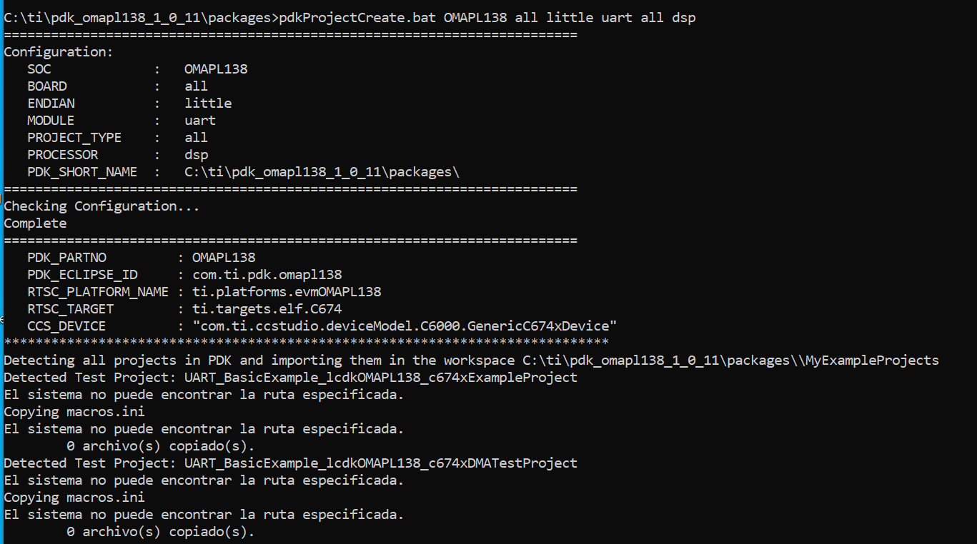

  • Here at the results that I mention above...
  • Just more information in case make thing clearer...
    I have redo almost everything to setup de enviroment:
    - C:\ti\processor_sdk_rtos_[soc]_[version]> setupenv.bat;  No problem with this
    - Build all, C:\ti\processor_sdk_rtos_[soc]_[version]> gmake -j4;  No problem with this
    - C:\ti\pdk_[soc]_[version]\packages> pdksetupenv.bat ;  No problem with this
    - C:\ti\pdk_[soc]_[version]\packages>gmake clean ;  No problem with this
    - C:\ti\pdk_[soc]_[version]\packages>gmake all;  No problem with this
    - Navigate to pdk_[soc]_[version]/packages and
    pdkProjectCreate.bat OMAPL138 all little uart all dsp
    Path is not found, see image below
    Please, any help will be appreciated.
    Joaquin.
  • Hi Joaquin,
    The CSL-FL examples are only available for the AM57xx and AM65x devices. I see this is not clearly stated in the documentation and I apologize for any confusion this may have caused.
    The error you are seeing is most likely due to the wrong CCS path being specified in the pdkProjectCreate script. If using a different version than what is specified in the Processor SDK release notes then you will need to update the path in the script to match your directory.
    This is also explained here now: [FAQ] OMAP-L13x/C674x Resources and FAQ
    Sahin

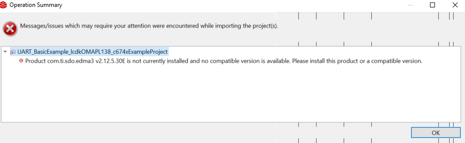

  • Hi Sahin,
    Thanks very much.
    I have changed to the actual version of the CCS and this is what I have now...
    If I try to load example form CCS that is what I have:
    In my intallation I have edma3_lld_2_12_05_30E.
    Any idea what is now the problem?

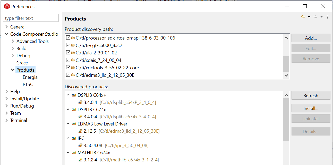

    I finally, reading looking at the foreo question  have solved the problem with the EDMA.
    Just add to CCS the EDMA products. See figure, below.
    Thank you all for your help.
    A somewhat curvy road but I got the end.
