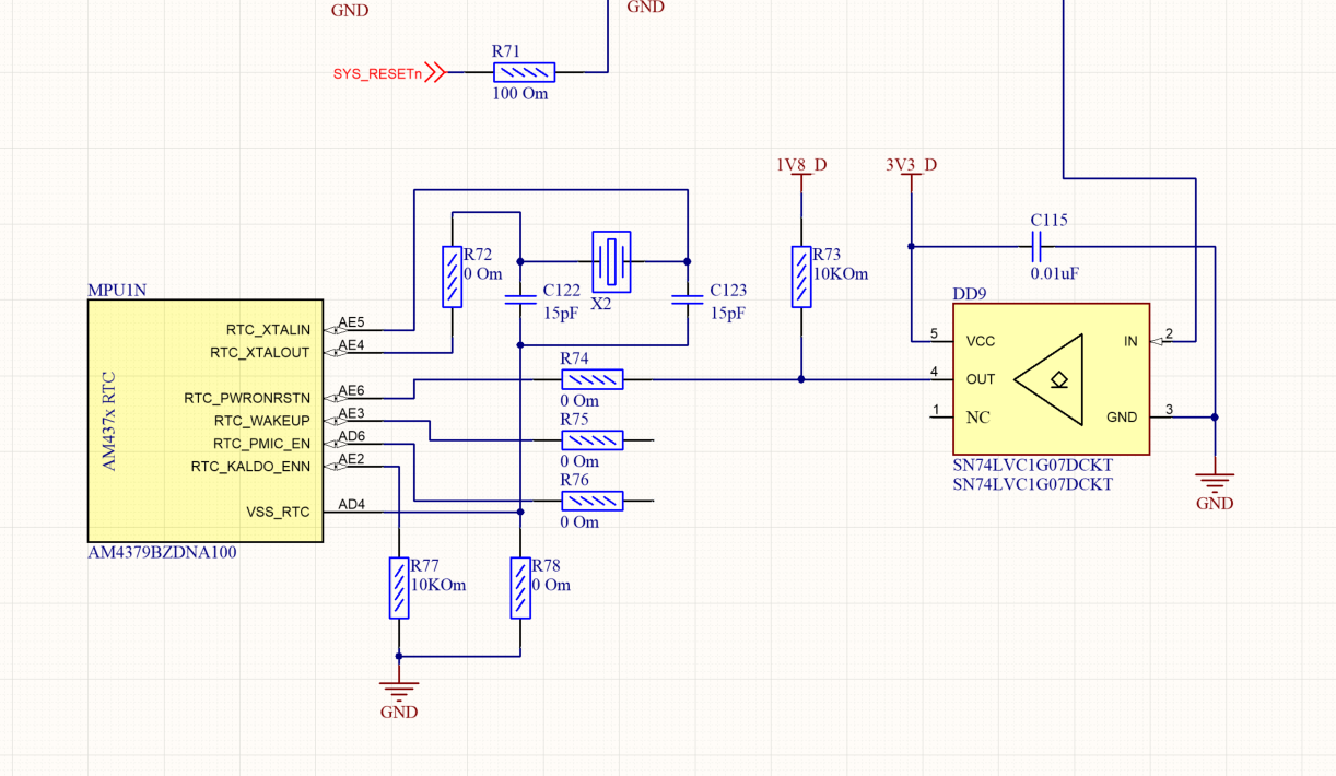

AM4379 have on chip RTC. I want power to be available RTC when the main power of the processor is off. I want use battery to power supply RTS. Is it possible? If so, how can I do it?

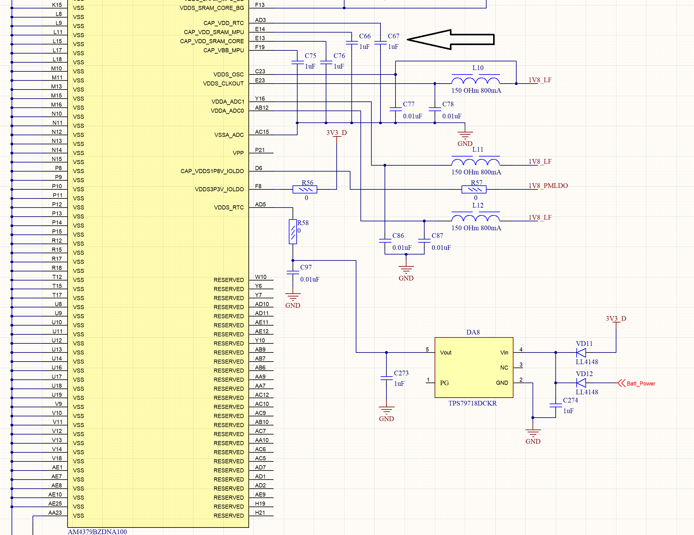

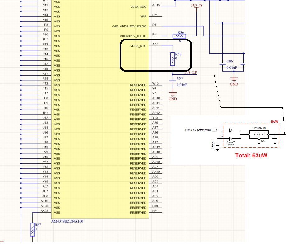

VDDS_RTC is the 1.8V power rail for the ADC.
You only need to source this power rail when the internal RTC LDO is enabled (RTC_KALDO_ENn = VSS) and the appropriate decoupling capacitor is connected to the CAP_VDD_RTC pin which connects to the LDO output and RTC core power rail.
Paul
I can see you are sourcing 1.8V to VDDS_RTC and you have a capacitor connected to CAP_VDD_RTC, but not able to see if you connected RTC_KALDO_ENn to VSS. If so, your RTC power source appears to connected as expected.
Your original post shows a 74LVC1G07 being used to source RTC_PWRONRSTn, but it was not clear what is sourcing the 74LVC1G07 input. This may need to be a independent reset source if you are trying to retain RTC information when the other portions of the device is powered off.
